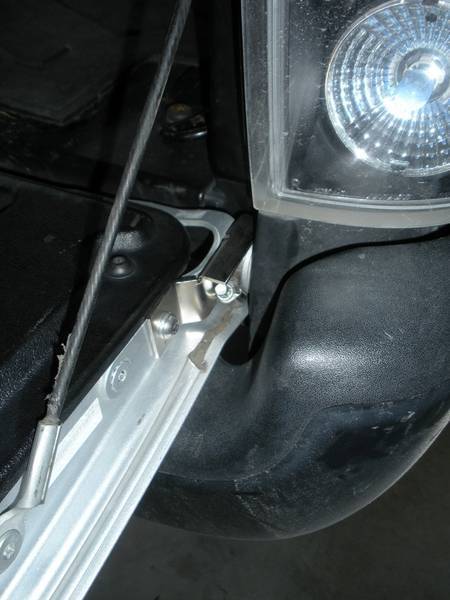

    locking latch, tonneau cover strapped to bedcleats, hose clamp mod with gatekeeper stainless bracket over it, cable washer mod = MY TAILGATE!

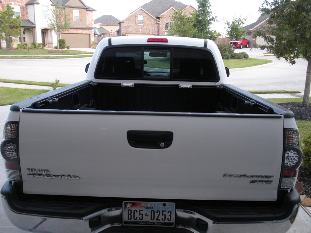

    way back in thread............been that way for years now.................part of it before tonneau...........
    old manual pl5100 popnloc..............
    old plate and tails too..........

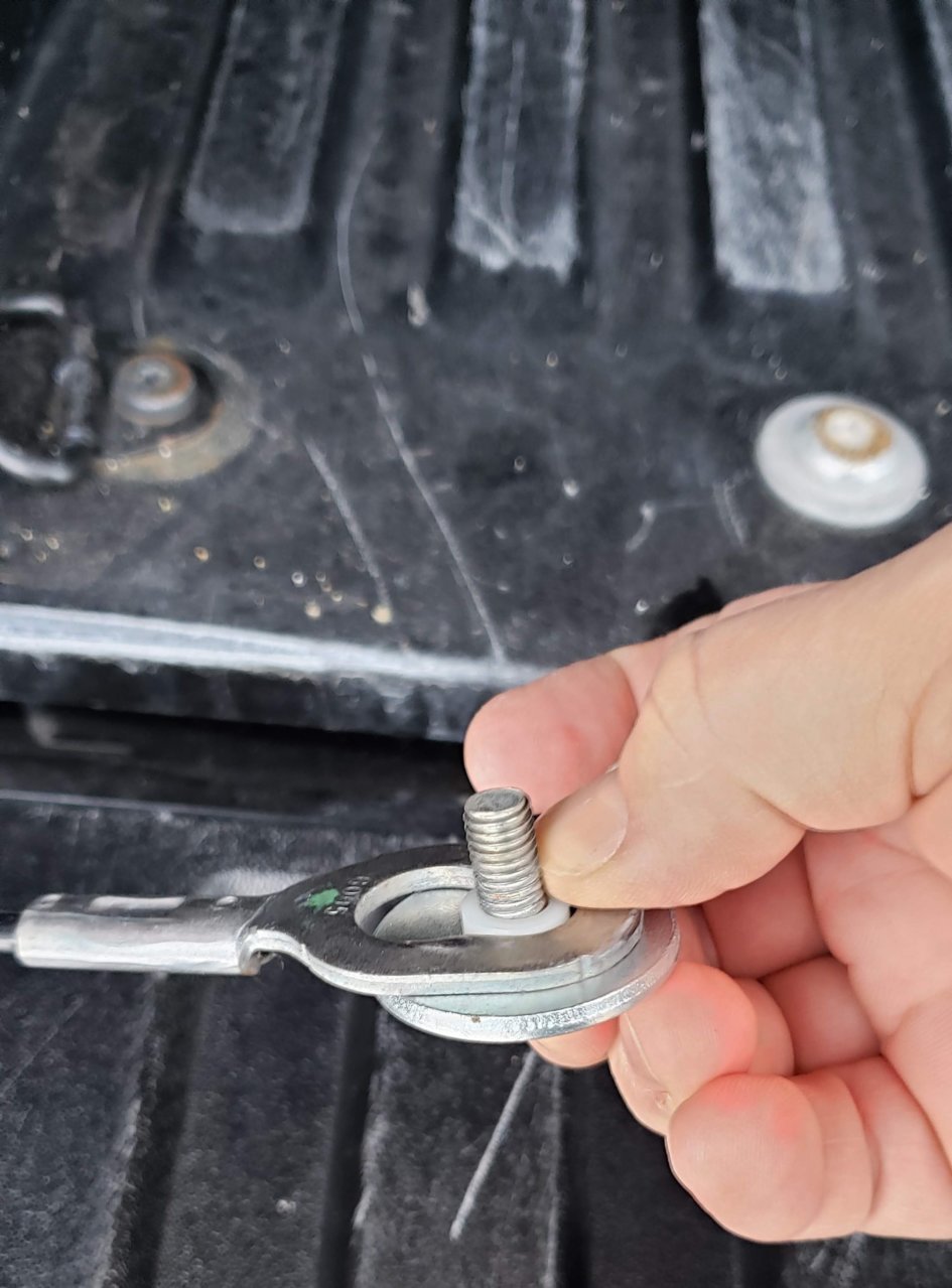

    ACE HW had the nylon washers (.500 x .317 x .125) that seem to fit just about perfectly. I installed some pretty robust (thick) 12mm x 40mm fender washers as the cable clip retainer, but when I fully tightened the torx bolt, it starts to bind up. I think I'll need to run back to a HW store and grab some less robust (thinner) fender washers or double-up the nylon washers to allow everything to work when I fully torque the torx bolt down. ACE also had the EZ lock pipe clamp which works just fine -- I was able to fully tighten this and everything seems to operate just fine. This is on a 2016 3rd gen tacoma.
    Update: Not the greatest pic, but shows that only one nylon washer gives just enough space for everything to sit flush. I did end up doubling these up and now the the cable clip retainer moves much more easily when the torx bolt is fully tightened.

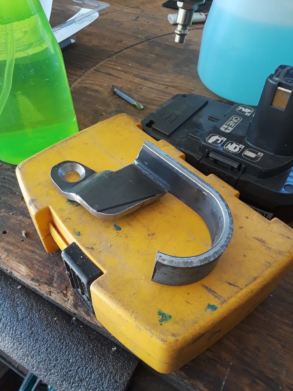

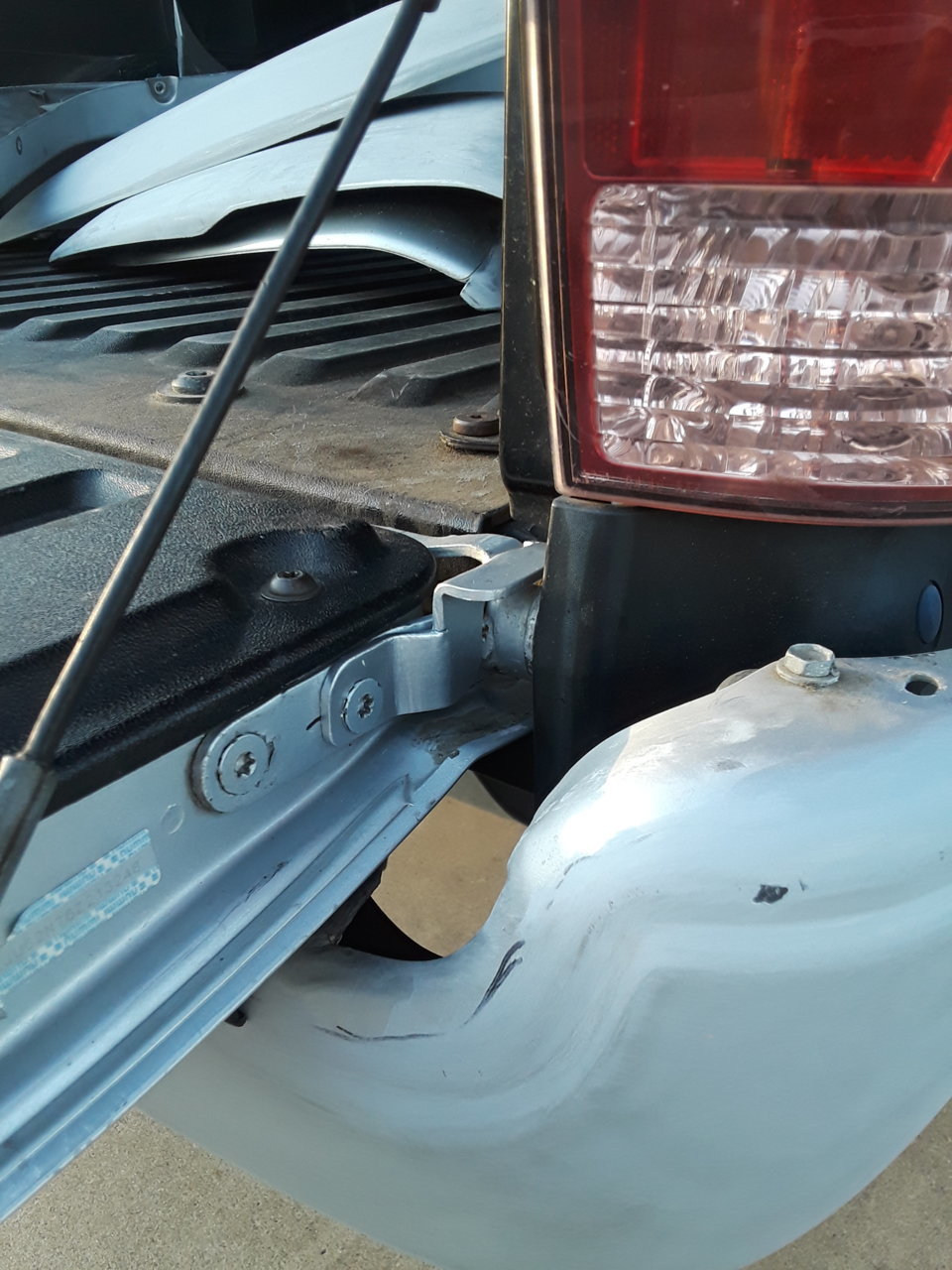

    Or I make these for 15 bucks shipped
    PM for details 3/16 steel ships in a day or two thx 20190316_122509.jpg 20190318_183059.jpg
