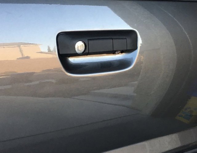

    If unlocked it takes about 15 seconds to remove my tailgate. Locked it requires the tools to break up he lock (drilling) and several minutes. I lock mine.

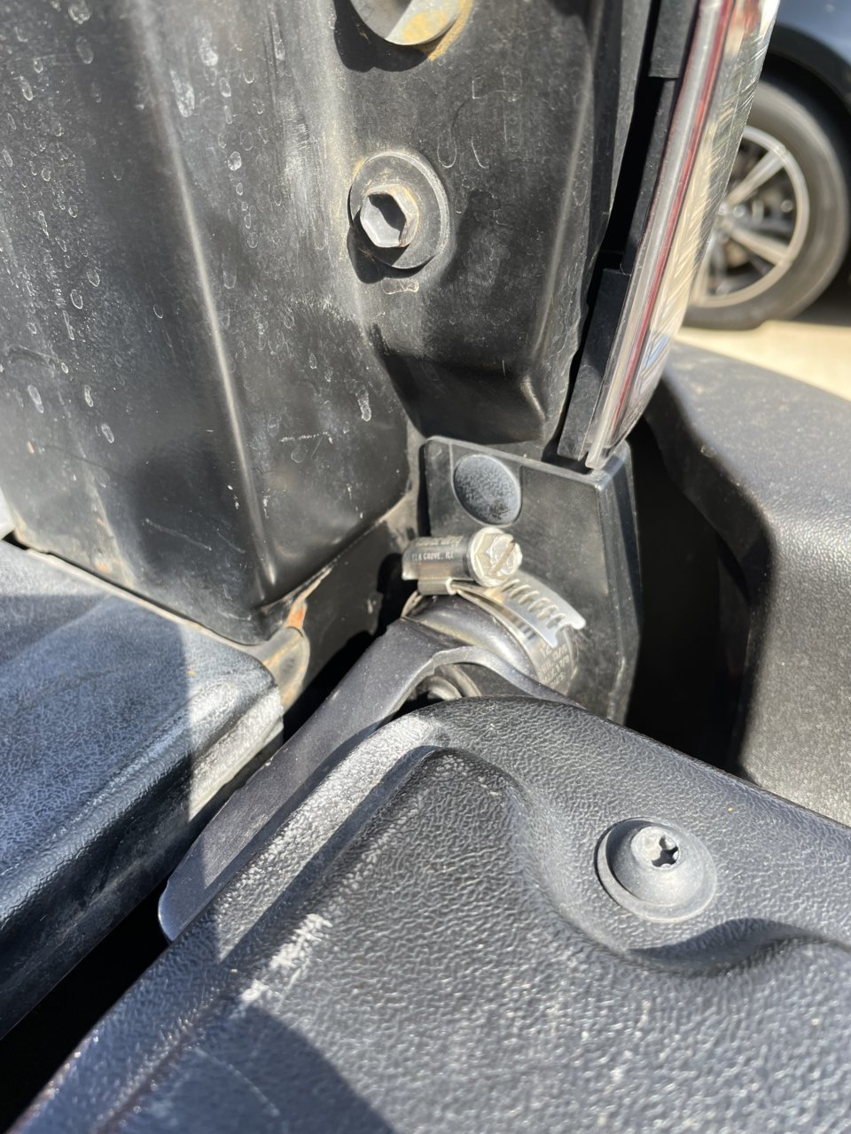

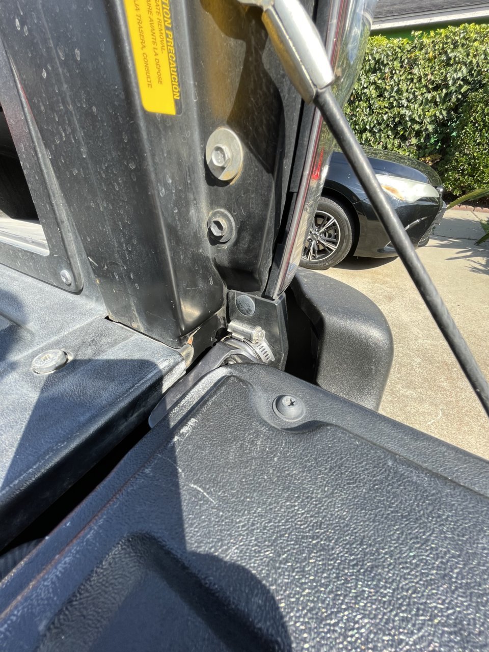

    I always knew that tailgates came off that easy but I didn’t think about people stealing them!!
    I got a hose clamp out of my garage for $0 and secured mine.
    Sure a thief can unscrew it, but they usually look for the quick swipe with a fast getaway.
    I installed the clamp then checked it a couple days later and moved it to be parallel with the the tailgate to avoid any rubbing. 036E72D7-F4D7-456A-A84A-C8A19803B67F.jpg4C43CD00-9D3E-4127-8760-D70D62679A16.jpg

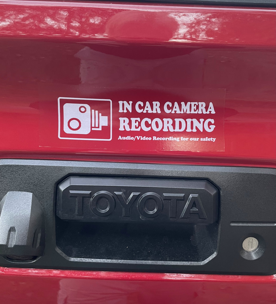

    Y'all definitely put the "fear of god" in me. I've starting to be really attentive to keeping it locked, and I have a forward and rear facing dash cam. I put the sticker above the handle as hopefully will be an additional deterrent; however, even if I got someone's face on camera, doesn't mean they won't sell it before it could be recovered. My tailgate would be more expensive too, since the truck has the black-out package. All that long explanation to say, thanks for the warning.

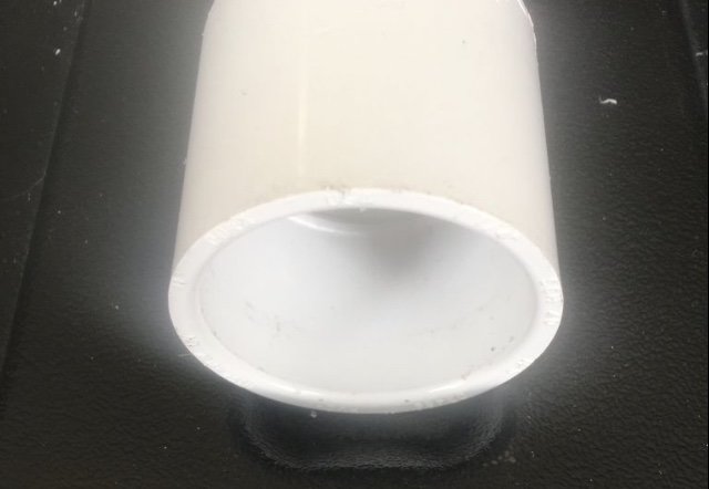

    Thanks for this thread!

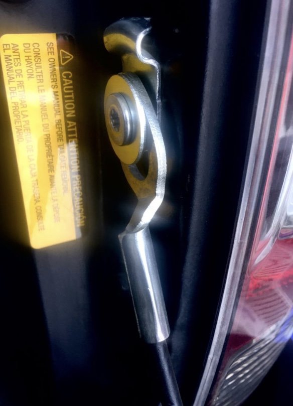

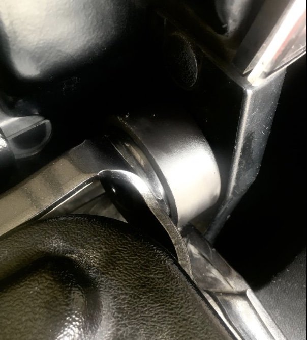

    I cut a spare PVC coupler to size, sprayed black & slipped it over the tailgate hinge.
    Added a washer
    Installed a Pop N Lock

    Thanks for the pics GGLV
    we put the SaBellCo Tailgate Lock, and after seen your post I just need to get some washers.
