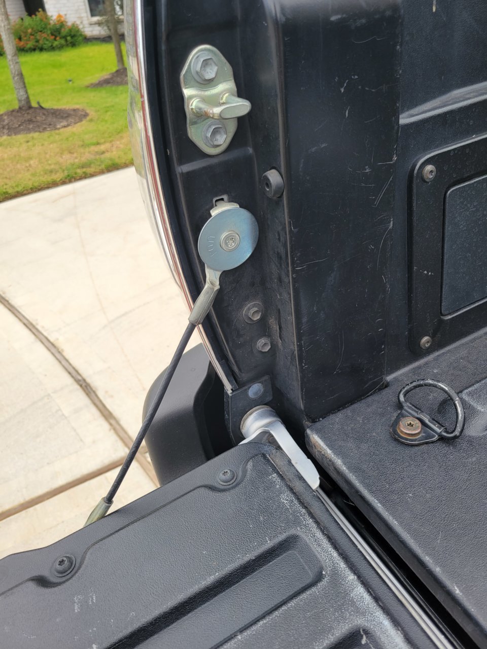

    My wife and I found a different solution that might be a sleeker. So grab some wahsers and a starbit and take off the upper cable hinge on both sides (do it one at a time). Refer to the picture, it's pretty straight forward and super easy.

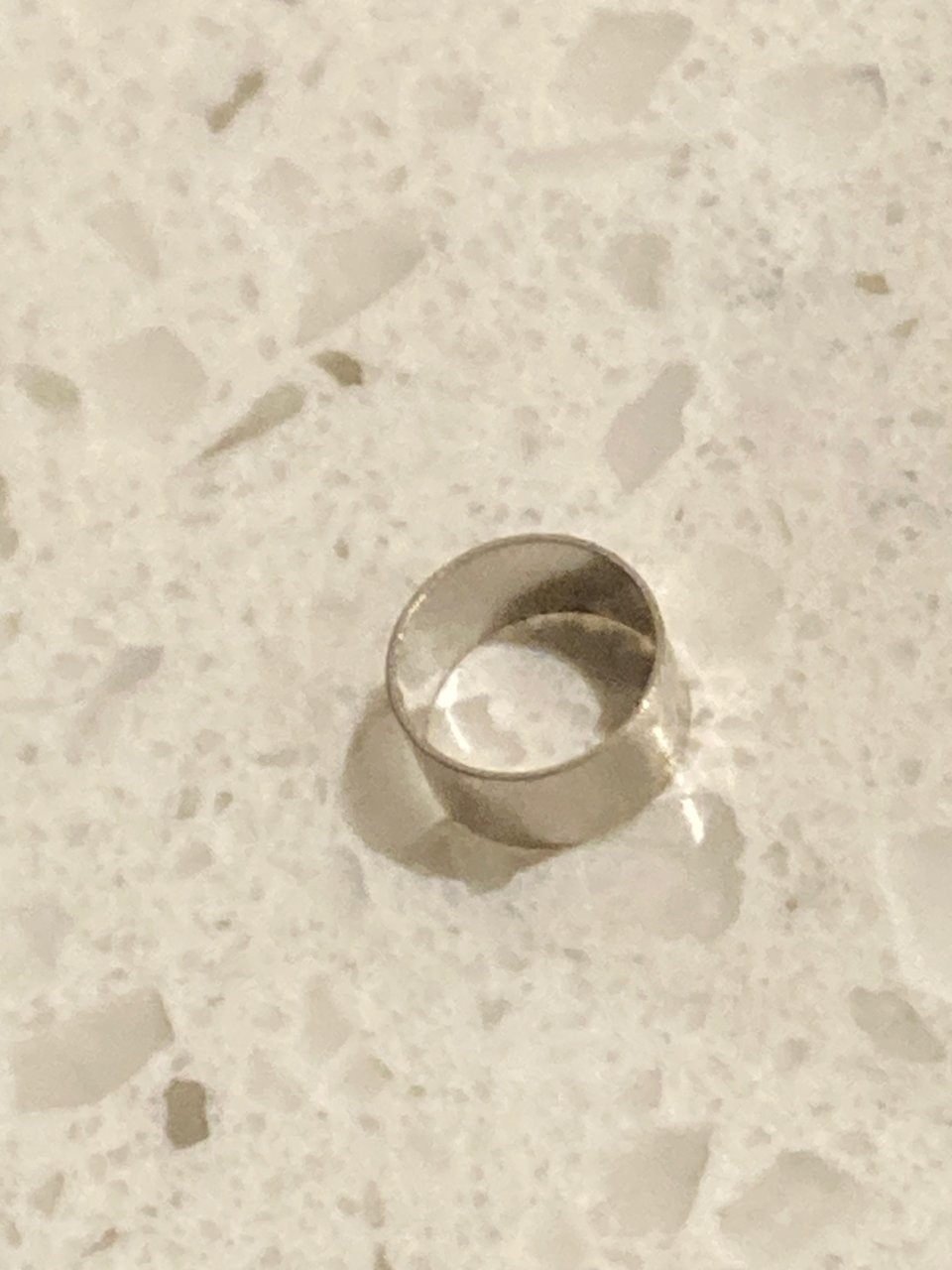

    Use as a spacer under the big fender-washer: to add an end to a coaxial cable people use a ring that is squeezed/compressed. Perfect fit around the retaining bolt. Look at Lowes in the "home wiring, phone and coaxial cables" section.
