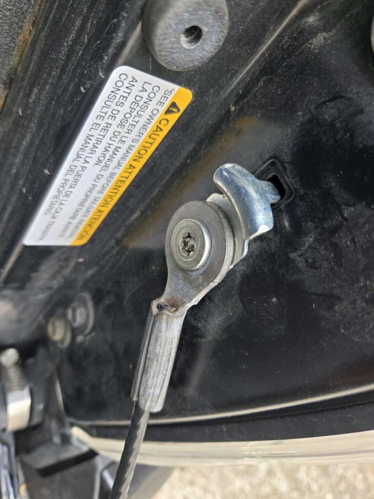

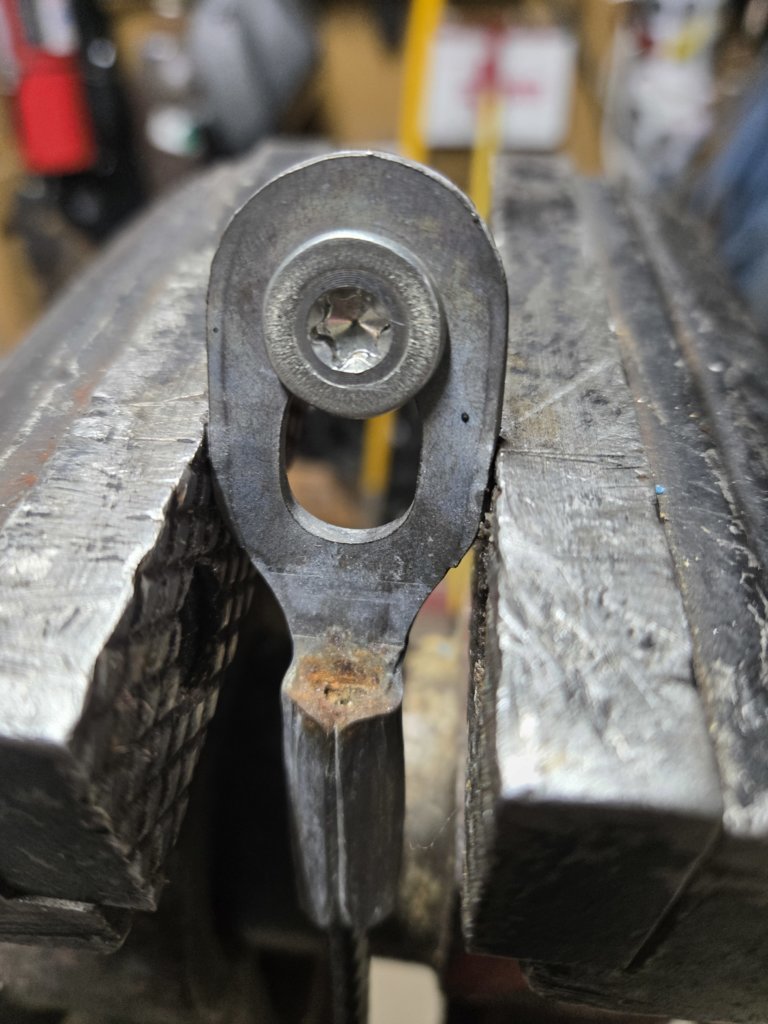

    OP: Using a washer over the cable eye works well, you have to put a spacer behind it though otherwise it won’t rotate on the bolt. Without it, I think pinching the cable eye was a great idea.
    Don’t depend on a hose clamp as a deterrent, you can pry and break those off with a screwdriver in less than 10 seconds. Try it.

    Yeah looking at that im going to remove the slotted mount and make a bracket and or TIG the slot closed. Ill never remove the tailgate

    The problem with that it has a torq (sp?) bolt that cab easily be removed which is why I drilled out the torq bolt heads - granted if you or the shop ever had to remove the tailgate you or the shop would have to take an angle grinder to the bolt head . . . . oh well.
