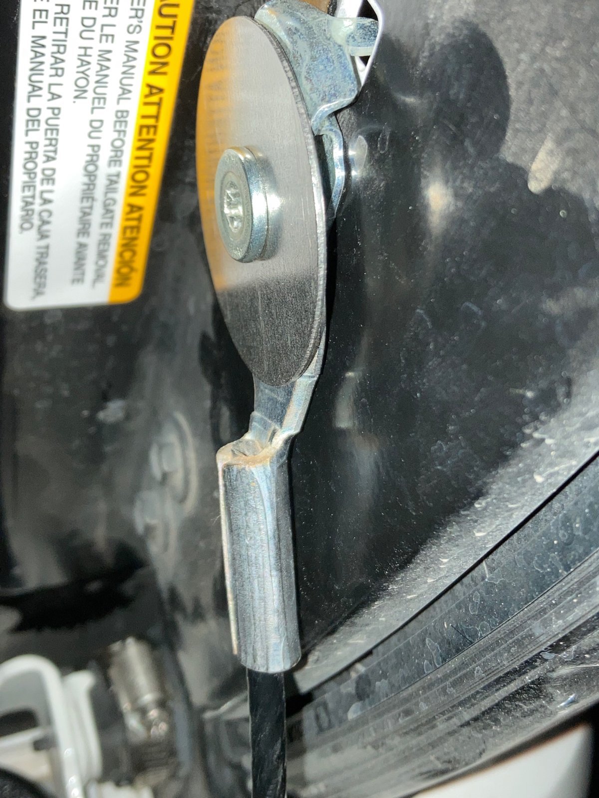

    i also added large washers to prevent cables from being detached.
    the associated bolts are torx and i had a real hard time getting them loose.
    i had to use vice grips to get them started. and so i used vice grips to snug them up again after
    washers added. it will take some doing for me to remove those cables if i ever need to...but i have not needed to in 5 yrs.
    i thief might try to cut the cables but i think that would be pretty tough. i am hoping for "better move on".
    Edit: just a heads up: It is not as easy as simply adding big washers. the torx bolt has to tighten up to a spacer in the hole of the washer. iirc, i widened the washer holes to accept a spacer. I think i fabbed the spacer from a nut, rounding the outside and reaming the threads out and shaving its width down to be just the right size to let the washer spin freely while providing a good surface to tighten the torx bolt up to. I used a drill press and belt sander...pretty easy just using scrap i found around the shop. better planning while cruising the isles of a hardware store would make a lot of the fab unnecessary, but where's the fun in that.
