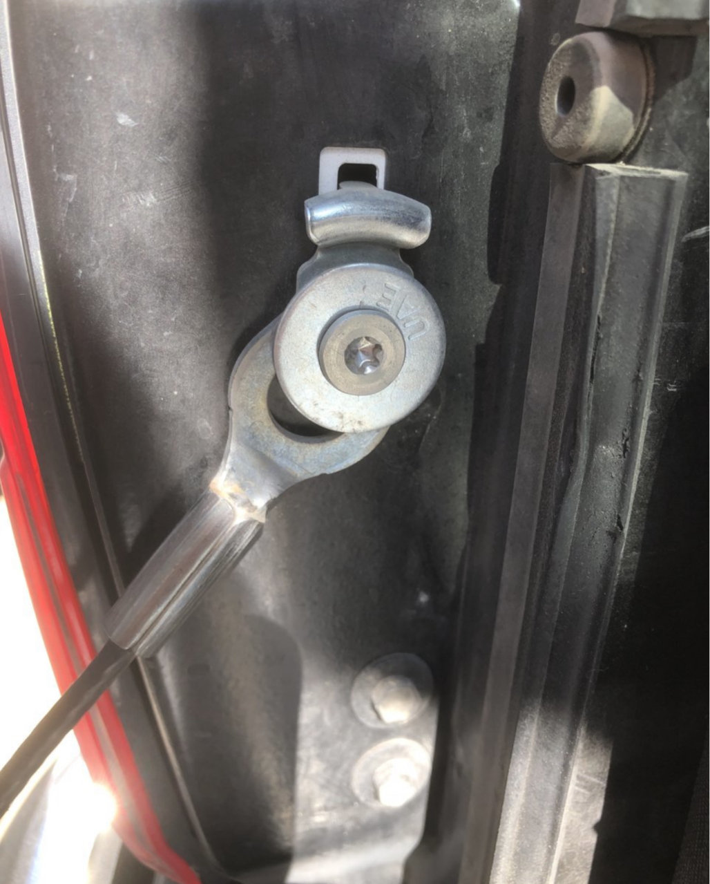

    :rofl:Less than 10 seconds- try breaking them off with a screwdriver.
    Sabelco or similar lock is best, also bolt washers and a spacer where the slip off cable eyelets go- the thief needs the right Torx head to take them off.

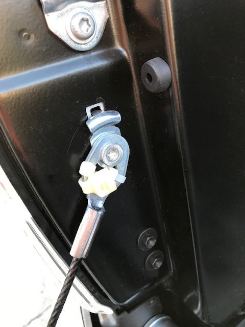

    but really, the hose clamp idea looks good, but it just takes a simple screw driver to pry and break off the strap on the clamp. I’d at least do that and the washers.

    Defeated easily with a screwdriver.

    +1 for that, I used zip ties

    For anyone looking to do the washer/spacer mod, the spacers that allow the cable to rotate freely are skateboard “speed washers”. Ask anyone you know who actively skates for 4 or go to your local skateshop. Both will usually have a parts bin and just give them to you.
    Otherwise speed washers can be found online in sets of 8 for cheap. Please support a shop or skate company rather than the jungle!
    Edit: link to post about washer mod that may be helpful
