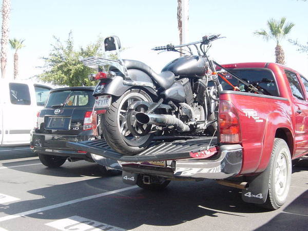

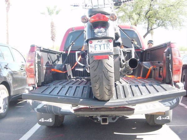

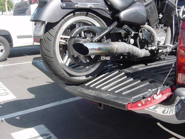

    I used to haul my 1507 CC Victory (dry weight of 650 lbs) all over the place with the rear tire on the tailgate, until...
    The tailgate crunched under the weight of the bike after going over a speed hump that i kinda did not see in the road.
    I went right over to the dealership and talked to the service manager... Thank god that i voiced my concern of buying a short bed with the salesmen before i bought it because i let him know i haul bikes all the time, and he said that it would be no problem and he admitted to telling me that, after it happened. After everything was said and done, They bought me a new painted tailgate!
    Now i have a 4 foot piece of 2" angle iron running the width of the tailgate welded to a 1/4" sheet of steel that the rear tire of the bike sits on to distribute the weight. Have not had a problem since!

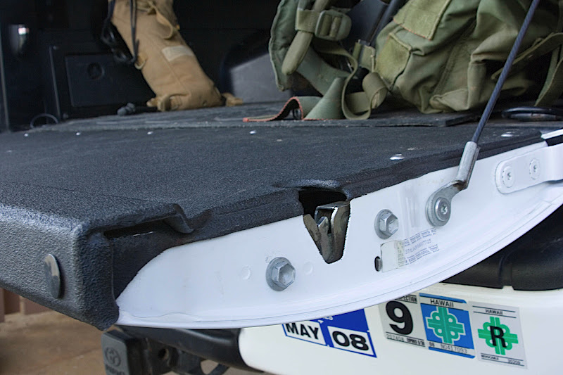

    any pics of that reinforcement?

    ... ^^^ ... Man, I like that a lot ... it looks very well made too ... is the vendor still making them ??? ..... Thanks ... :D

    That guy stopped making them in 2007.

    I believe I made the original in 07 and it was copied and sold on TN. The cad drawing can still be found somewhere on the site still i think.
    I still make them, you can find them on my site relentlessfabrication.us
    Have one aluminum one in stock at the moment actually.

    An aluminum one would be great. My tailgate is heavy with that thing on there.

    How much does it weigh?

    Aluminum diamond plate cover is only 13lbs.

    Well it takes two people to get it on and off without banging it around. I would say around 60-70 pounds total
