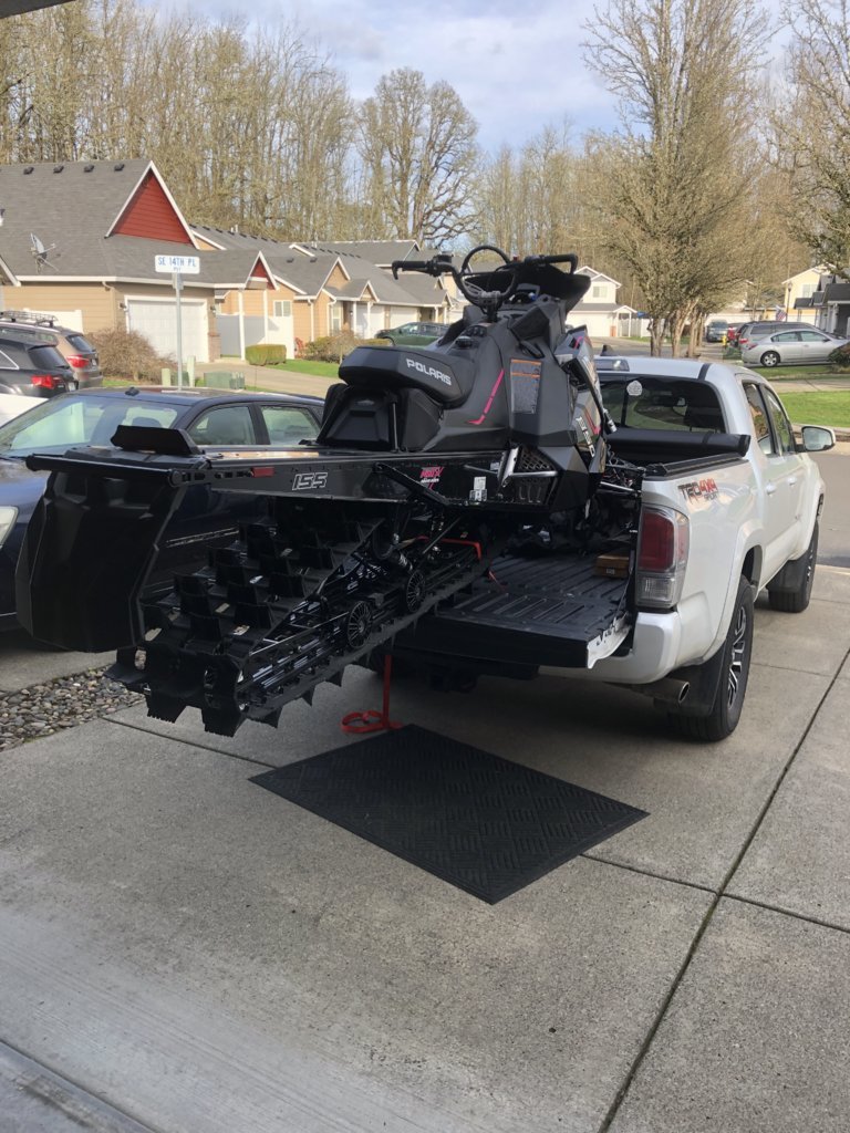

    by “sled” you mean snowmobile? Any pictures of how that thing was loaded?
    working on ways to get a 2021 RMK into my 2022 TRD Sport Short Bed Double Cab

    For reference, this has done a cross country trip no problem. Only smooth paved roads in summer, not bumpy winter off-roading.

    FWIW- I weigh just under 300lbs and I’ve slowly ridden my ~500lb SkiDoo up a 10ft ramp (resting on my tailgate) and into my box on a few occasions....
