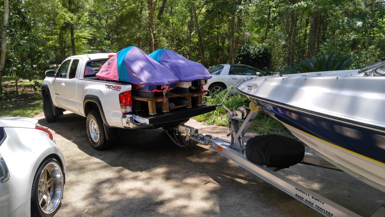

    Here's a 1000 pounds in the bed. Winched up a ramp. The stock tailgate held up fine. The next time I did this though I added chains to support the cables because that seemed to be the weak part. I'll add a Mobtown tailgate skin too but the stock stuff did hold up.
