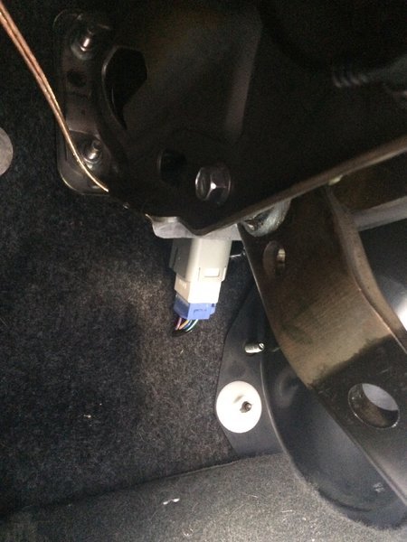

    The blue and white connector seen here is the brake light switch on my 2015. At the top of the plug is the switch. Move the pedal a few times and you should see how it works, or at least how it's supposed to. Also make sure the plug is in all the way. And all connections aren't compromised.

    The top of that got broken off, so it's no longer connected, I was thinking I could possibly try supergluing it back together for a quick fix?

    New switch/plug? Someone here might know a part number. Or if you're lucky enough to have a wrecker nearby, you could try and find a Tacoma and pull what you need.

    Should work for now. Even duct tape might work, but I'd be nervous about leaving it with a temporary fix for too long. The threat of getting rear ended in winter is too great.
