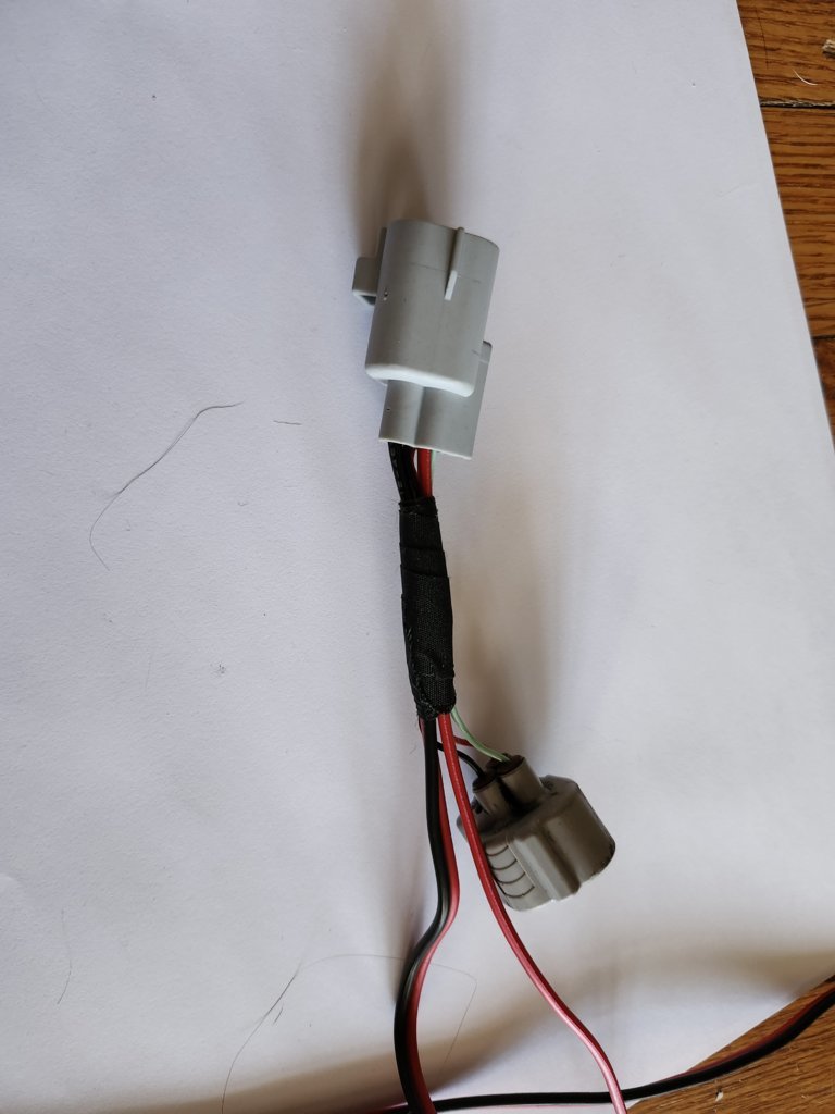

    I just made one today. Yours would be alot more complicated. Mine is brake and running light. Maybe i can put a couple together , it would have to be one for each tailight because of turn signals. 20250302_073727.jpg

    I could probably make a set if it's for a 3rd gen. It would be 4 harnesses.... reverse, brake and running, and 1 for each signal... I'll look into it the next couple days and get back to you.

    @Jsevert2023 is correct, you will need 4 harnesses to accomplish that on a 3rd gen. Do you have a picture of the light bar connection? Making something plug and play should be pretty straightforward. If @Jsevert2023 doesnt end up doing it for you, feel free to shoot me a PM. I have everything you’d need and can most likely mate to the light bar.
    @Matt Sierra is on to a good starting point for the 4th gen, but the issue with the 7 pin is you are going to have a combined brake and turn signal. Your taillights are this way as well, so either way you go, you will need to separate those two if you require an isolated brake and turn signals. The ones I’ve made for some of the 4th gen’s have used Curt controllers to split the brake from the turn signals. Still all plug and play, but some added hardware unfortunately. If you’re untested though, feel free to shoot me a PM as well. I’ve been doing these for a while now. It’s all crimped connections with 18g TXL (or larger, depending on what we are tapping) wire and OEM equivalent connectors.
    For what it’s worth, the 2nd gen is the easiest as everything is in one plug. You still need two if you’re grabbing the turn signals, but it’s nice to have brake, parking, ground, reverse, and one turn all right there.
