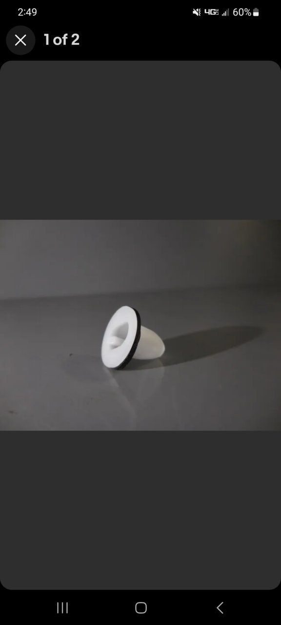

    2022 taco i just install taillights but I think the white clip on top not good cuz the taillight won't click in and there a little gap where water can get in the other is great dose any no like the item number or get a new clip

    clip on the top of Taillight where you clip in its white

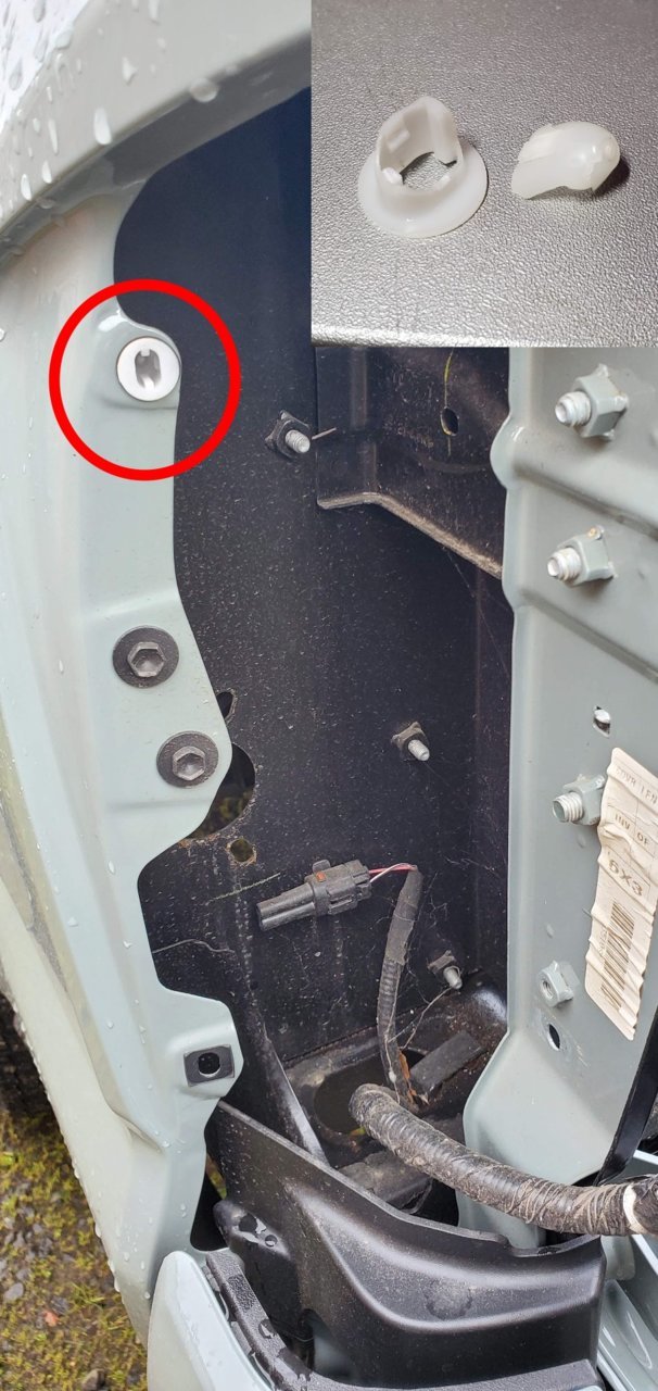

    I think it’s ~ The clip thats in the truck fender where the metal taillight pins engage?

    Yea that's the one I think it's bad because it won't click and the taillight not flush kinda lose on the top little gap

    Try popping it off of the tail light, insert it into the sheet metal, and then pop the tail light in. They're usually a pain to get off the light.

    I did but with new tail it won't click In so am thinking clip no good cuz light Loose uptop

    Any of u no the clip number to order one thanks

    81496-0E020

    You can also take the old clip to an auto parts store and they can match it up to a new non-OEM clip.

    I appreciate the help in this thread. My clip broke as well. It was being super stubborn and decided to break on me. I'm hoping my local dealer has one in stop and not at a ridiculous price xD
