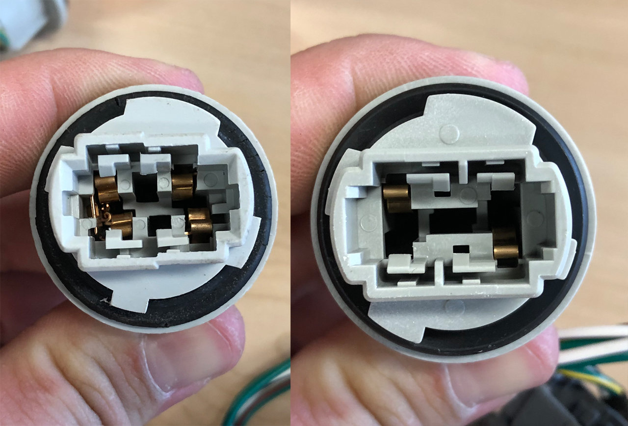

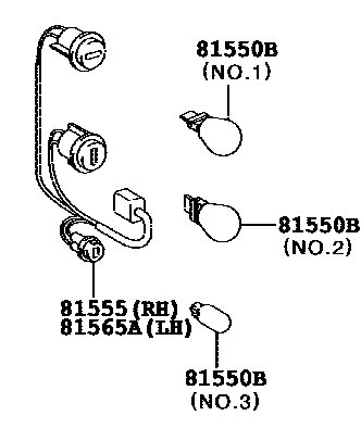

    Anyone have the part number for the harness that leads from the truck to the turn/running/reverse lights?
    I'm switching back from Alpharex to OEM style and can't find the harness. Thank you!

    When I changed to Spyder aftermarket tails, I found that my OEM LED lights used harness 81555-04160 (shown below on left) and the other "non-LED" harness that my tails required was 81555-04150 (right). Depends what shape your Alpharex lights have for the plug.

    That is good to know. I have a 2013 and I need the cable that plugs into that part so I can go back to regular tail lights. Or I have to buy a replacement Alpha Rex light.
