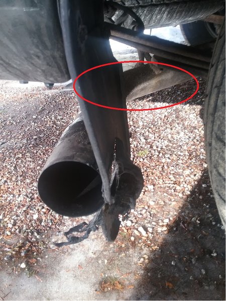

    I guess the tailpipe bent. Should I just bend it back myself or is it more complicated than it looks? Or is it indeed bent? Here's a link with pics: http://goo.gl/photos/yKBcReRx4umbWqej9

    You'll need to heat the area up you want to bend, and use a pipe or some other strong and long object (lever), inserted into the tailpipe to bend it.

    Looks like the tube is pinched/twisted here.. maybe you backed into something and contacted the tailpipe?

    Only way to bend it back.
    If you don't have a good hot torch (oxy/acetylene or MAPP gas), you can buy a MAPP setup at Home Depot for $40-50 or so. But, it might be easier and cheaper to just swing by an exhaust shop in your area and have them do it. I'd be surprised if they charge you more than $20-30.

    Yup must have been snowbank. I didn't notice the crimping. Thanks for pointing that out!

    I cut my tailpipe back to where the bend is coming down.
    Stays out of the way.
