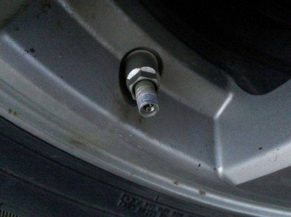

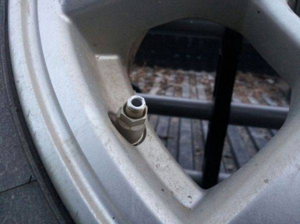

    Don't use metal valve stem lids unless you're certain the metals won't mate and fornicate yee day as it has mine.

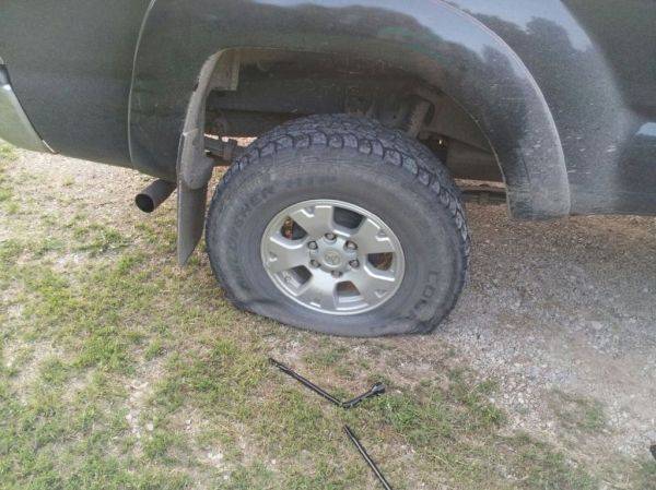

    remove valve stem cap and get the entire thing. Quick, move it to level ground!
    Front stems are corded like crazy
    rear sheared right off, didn't even chance taking the remaining caps off to inspect the stems, I'm out of spares!
    Learn from my misfortune everyone, keep the stock plastic caps. Stay away from the showy metal ones.

    I work at a garage and I see this all the time. People put on the crome caps on there metal sensor stems. They corrod all the time when not checked. And then your screwed and will need to get a new sensor.
    Now if u are having trouble removing other ones. Here's a tip but be VERY careful u can use a lighter to heat up the cap and gently use pliers to wiggle and pull it off.
    This doesn't work all the time but sometime it does

    Our TPSM and valve stems are one piece apparently. So im into two new sensors at $60 each. At least the new two will be the two piece rebuildable ones for cheaper adventures in the future.
