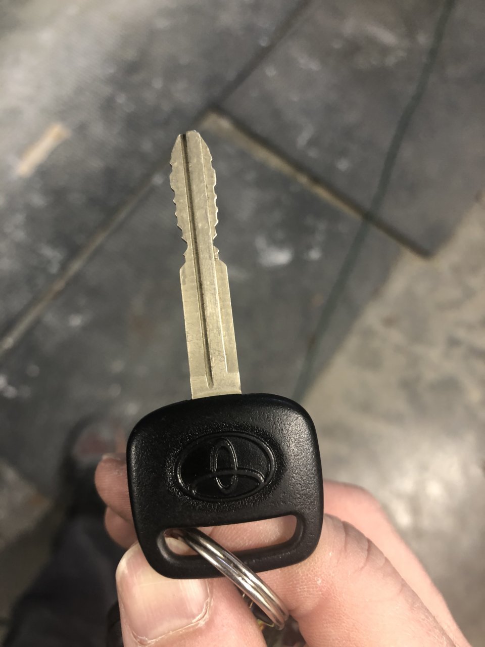

    Hello there, just taking a big big punt. I wonder if anyone has a similar key and could give me the number so I can order one. I did cut one at Home Depot but it is too worn to be effective.
    Maybe I get lucky....

    Go to your local Toyota Dealership with your VIN and proof of ownership and ID. They should be able to decode the vin and get a key code to cut the key.

    I did this to get the exact key in OPs photo with the etched Toyota logo and all. Cost $7 in 2012

    Take to key to a small lock and key store. The automated key machines don’t have the finesse needed to copy a worn key. Someone with a manual key machine can cut that for you. I used to work at HD many years ago, back before the automated key machines were even a thing. I personally cut a bunch of keys that looked like that or worse and never had any issues. It might take a try or two but it’s actually pretty easy.

    Being friends with Locksmiths makes things so easy.
    Pop out the right door cylinder they tend to have the least wear.
    I would just get the glove compartment cylinder rebuilt and a new key made

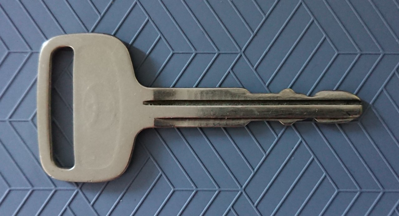

    I went from that style key to this one for like $7. A lock shop can cut a working key for you. Or you can do what I did and bring the locks from your doors and ignition into the shop with the new key blank as well as the worn key... they will be able to cut you a fresh key and rework the lock mechanisms so that you’re no longer depending on a worn key to operate your vehicle. They also sent me home with a key code to use if I ever lose my keys and need a new one cut.

    I was charged $7 per key, cut from my VIN at the dealer. We've given you the answer, maybe trust us?

    I have the same key as you and it was so worn i couldnt open my door. Took it to my local key guy (I used to deliver keys for them so I knew where to go) and they cut a copy that works perfect.

    we cut new keys for customers all the time for i think 15 bucks.. You just need to bring the proof of owner ship in and an ID. Toyota will release the key number and they cut it right there. shouldnt cost any extra
