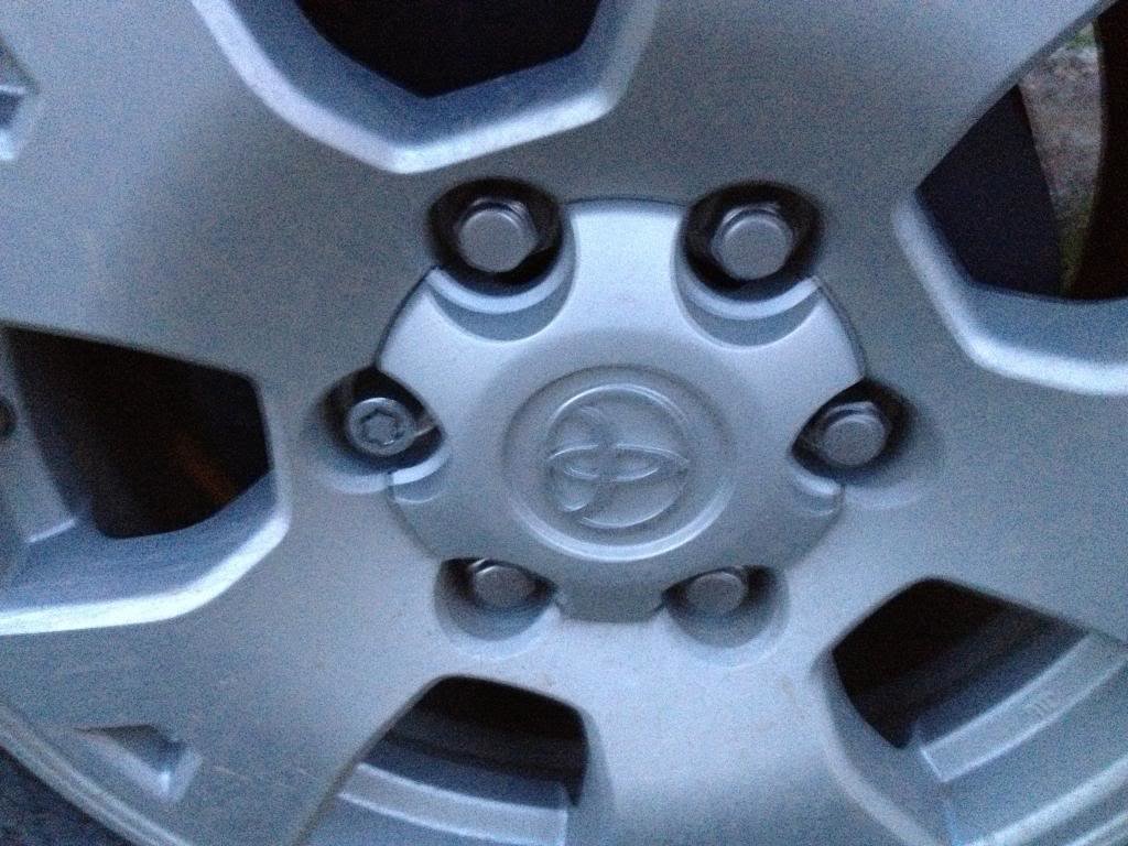

    Hey everyone!
    Today I was trying to dip the emblem on the centre of my stock rim. I tried to twice and had some issues so I took the dip off. I was wondering if it was possible to take the rim cap off? Would I have to remove the wheel to do it? If I can it would be so much easier to dip the emblem.

    They just pop off and clip on. u can run a screwdriver down by the lug nut and use the nut as a fulcrim to pry it up on one side if u can't just pull it off

    be careful, you can break it with a screwdriver

    Oh awesome! The sun is gone now so I have to bring it inside. Thanks for the help. Much appreciated.

    Oh I don't do metal on plastic anymore, even with tape over the metal(does nothing). Many years of breaking and trying not to break something when using metal to plastic. I have plastic removal tools now, best money I have ever spent.
