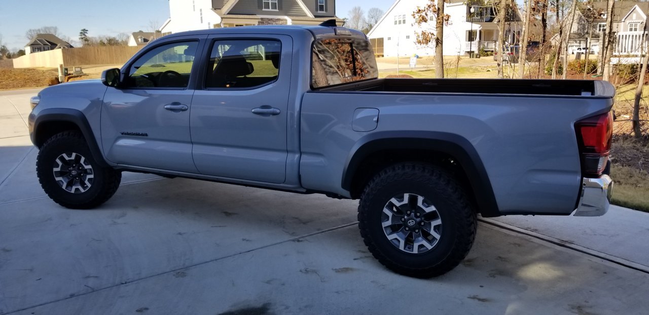

    I just did that. I used a hair dryer on the sticker. The heat warms it up so it is less brittle and softens the adhesive allowing you to peel off big chunks instead of it breaking into smaller bits if you try to peel it off cold. Don't let the heat stay on too long at a shot or the sticker actually melts.
    To deal with the adhesive residue left behind I used my fingers to apply Skin So Soft (magic Avon product that does everything from repel mosquitoes to removing paint) then went back to work with the hair dryer, paper towels, and one of those kitchen sponges with the mesh covering. The hair dryer softens up the adhesive while the rubbing with paper towels and the sponge rolled it up into little boogers.
    Rinsed with soapy then clear water to get rid of the SSS then a light coat of plain Johnson's Paste Wax in the affected areas. Truck needs a bath but here is the before and after of the "remove tacky decal" mod.
