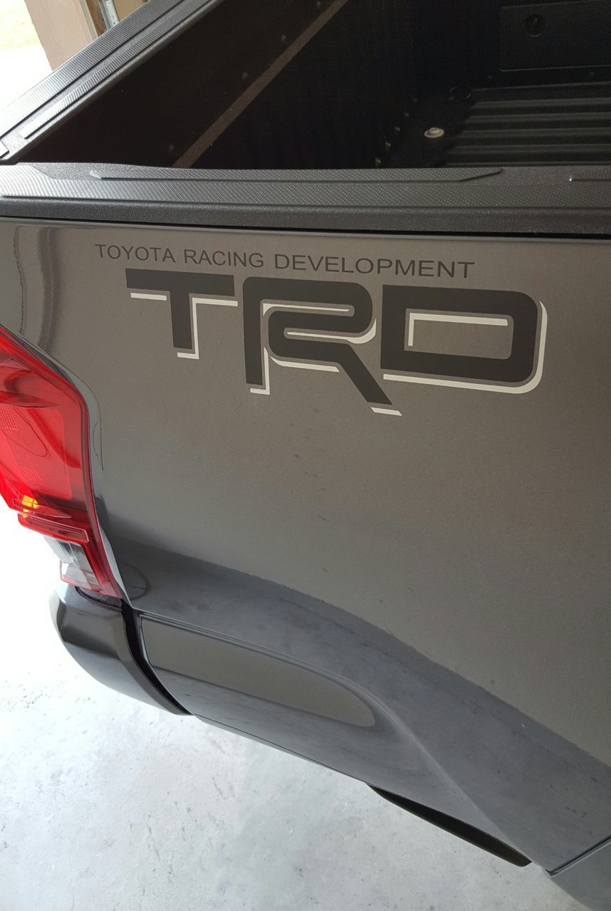

    Use a steamer similar to the one you use for your clothes. This will heat the decal up and softens the adhesive slow so it all comes off in one pull with no need for goo gone or chemicals to get the adhesive. This works best with decals. To remove double sided tape such as the stuff underneath an eraser wheel will make your life 100X easier.

    I did it w/o a heat gun, you can just park your truck in the sun for a few hours, the sheet metal heats up nicely.

    I just bought a 2019 Super White access cab TRD Sport.
    I took them all off in about an hour including the door "Tacoma" chrome, tailgate "V6" emblem.
    No more chin spoiler either. Straight to the trash. Next, the headrests come out.
    Thanks for the heat gun tip, I had forgotten how I did them on my 2007.

    Heat + Fishing Line + Goo Gone

    Emblems: Heat gun on high, start on the letter "A" with a yellow plastic (HF) pry tool. I used a rag here too, but if you are careful, once you get under it and get it going, they come right off. Then you carefully heat the black goo left on the paint and roll it off like a booger. I use a very soft towel with Goof Off to get the residue off. Buff it with another very soft towel. You can't tell anything was ever there. I bought the truck last night, and took all this stuff off first thing this morning. Best to do it when the truck is brand new, now shadowing/discoloring issues. What was Toyota thinking about on that hideous chin spoiler?

    Use goo gone not goof off

    I had no issues with goof off. You must be careful with this whole process, but it came out fine.
    Goo Gone is probably less harsh.
