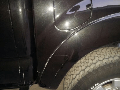

    after buffing out some scratches of my truck and some much needed waxing i cant seem to wash off the compound and wax residue off the plastic trimming. unless i scrape it off but leaves a scrath on the trimming. is there an easier way to take the residue off without messing up the paint or wax around the trimming or leaving the plastic messed up?
    heres a pic of what im talking about.

    Just get the majority of it off manually, with your hand, and a damp rag. From there, you'll still have a white residue. There are a few companies that make a product for removing this residue. Mothers makes a product called "final inspection" (I'm pretty sure that's the name) works great. There's also "back to black" which should work for ya.
    Just go to any auto parts store that stocks paint shop supplies, and ask the clerk, they'll have something for ya.
    Then next time you wax/polish, just make sure to mask off the rubbers.

    X2 on the final inspection spray, or any detailing spray for that matter. It takes off wax and polish residue and leaves the paint nice and shiny!

    Soft toothbrush will get it from the cracks.

    careful use of a toothpick might help.

    Armor all or similar works.

    soft tooth brush or a specialty detail brush will do the trick. Also after your done doing that you can use an aerosol dressing to shine it up. it can be found from a company called automagis or P&S auto care. If your going to use these products apply them before you wax due to overspray. Good luck. Any questions let me know.

    mothers back to black

    I use Meguires Ultimate Liquid Wax and it doesn't leave a mark on my trim.
    For my twice yearly 3 step (Clay, Sealer/Glaze, and Wax) I used Mothers Sealer / Glaze for step 2. It did leave some white marks on my black plastic trim - none on the rubber trim. Nothing seemed to take it off until I used a pencil eraser - worked great. I read a Mr Clean Magic Eraser will work even better.
    I use the sealer / glaze as step 2 because using a polish takes some clear off each time. I will substitute a non- agressive polish (such as Meguires Color-X) when swirl removal is needed.

    Just switch to Turtle Wax Ice synthetic paste. You can polish all the trim and plastic with it and it will never leave white residue and protects everything. As far as getting yours cleaned back up, good luck!
