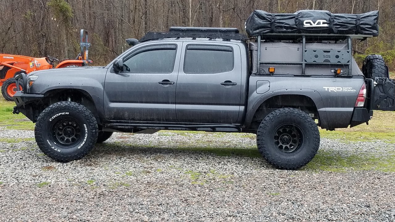

    Decision has been made. Going white out. Now for this weather to clear. Need to get the tranny cooler on before the 35s.20180320_123955.jpg

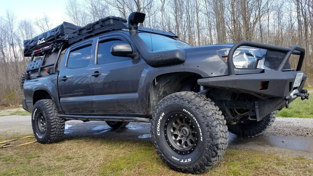

    35s are on . Cab mount needs more:sawzall:20180323_150625.jpg

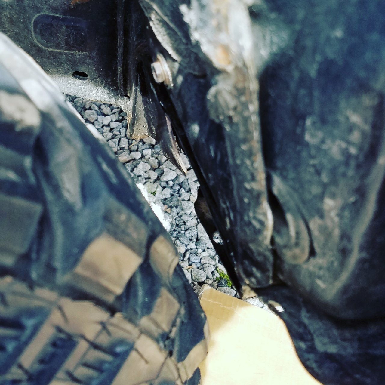

    These coopers are surprisingly quite. Just a low hum. I think the cab mount is going to get to meet my grinder in the morning:sawzall: its a slight rub at full lock but its enough to become a problem when the tires get stuffed.

    Took out my aggressions on my cab mount this morning. Why is cutting my truck getting to be fun:sawzall::welder:IMG_20180324_144638_418.jpg

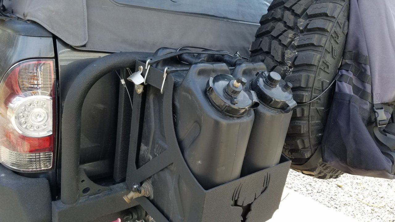

    I did this awhile back but never got a pic. Dual jerry cans. The driver side one has a rain barrel spigot from Amazon and an air valve on top. You can vent it for gravity fed water or connect air for pressurized water. And of course the bottle opener:drunk:20180329_113105.jpg

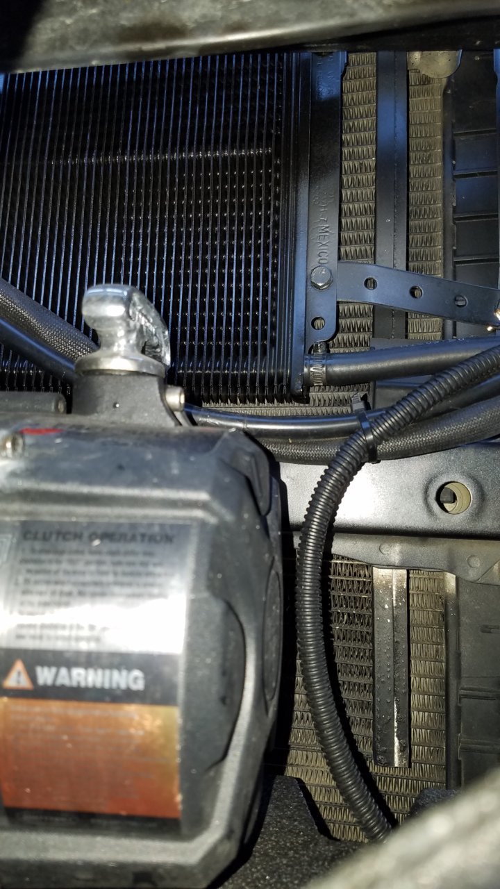

    Tranny cooler is on and working fine. Dropped my temps about 20 degrees or so. 20180328_085227.jpg

  13. Mar 29, 2018 at 9:45 AM

  14. Mar 29, 2018 at 9:50 AM
    #94
    fatfurious2
    Jun 28, 2014
    #132884
    49,732
    David
    Ashburn, VA
    2010 TRD OR Access Cab
    part number?
  15. Mar 29, 2018 at 4:11 PM
    #95
    TaKoToy
    TaKoToy [OP] Well-Known Member
    Jul 16, 2013
    #108417
    3,916
    Robbie
    Prince George VA
    2013 4x4 OffRoad, 2020 cement DCLB OR
    Mostly stock
  16. Mar 29, 2018 at 4:13 PM
    #96
    fatfurious2
    Jun 28, 2014
    #132884
    49,732
    David
    Ashburn, VA
    Thanks. I am going to look into this. Hopefully will fit with all my SC stuff in the grill area.
    Was it just clamp the original line, take off the stock cooler, and then install the new one?
  17. Mar 29, 2018 at 5:35 PM
    #97
    TaKoToy
    Jul 16, 2013
    #108417
    3,916
    Robbie
    Prince George VA
    Mostly stock
    No tow package on my truck so it was a fresh install. I ran the output of the radiator to the cooler and back to transmission return at radiator. Was fairly easy. I imagine if you already have a cooler it would be even easier.
