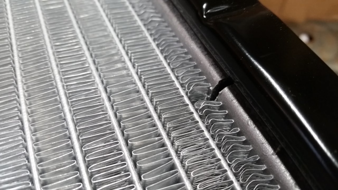

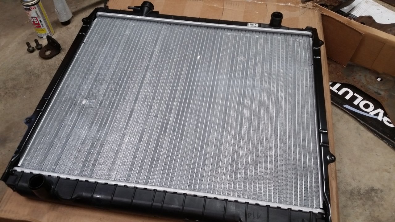

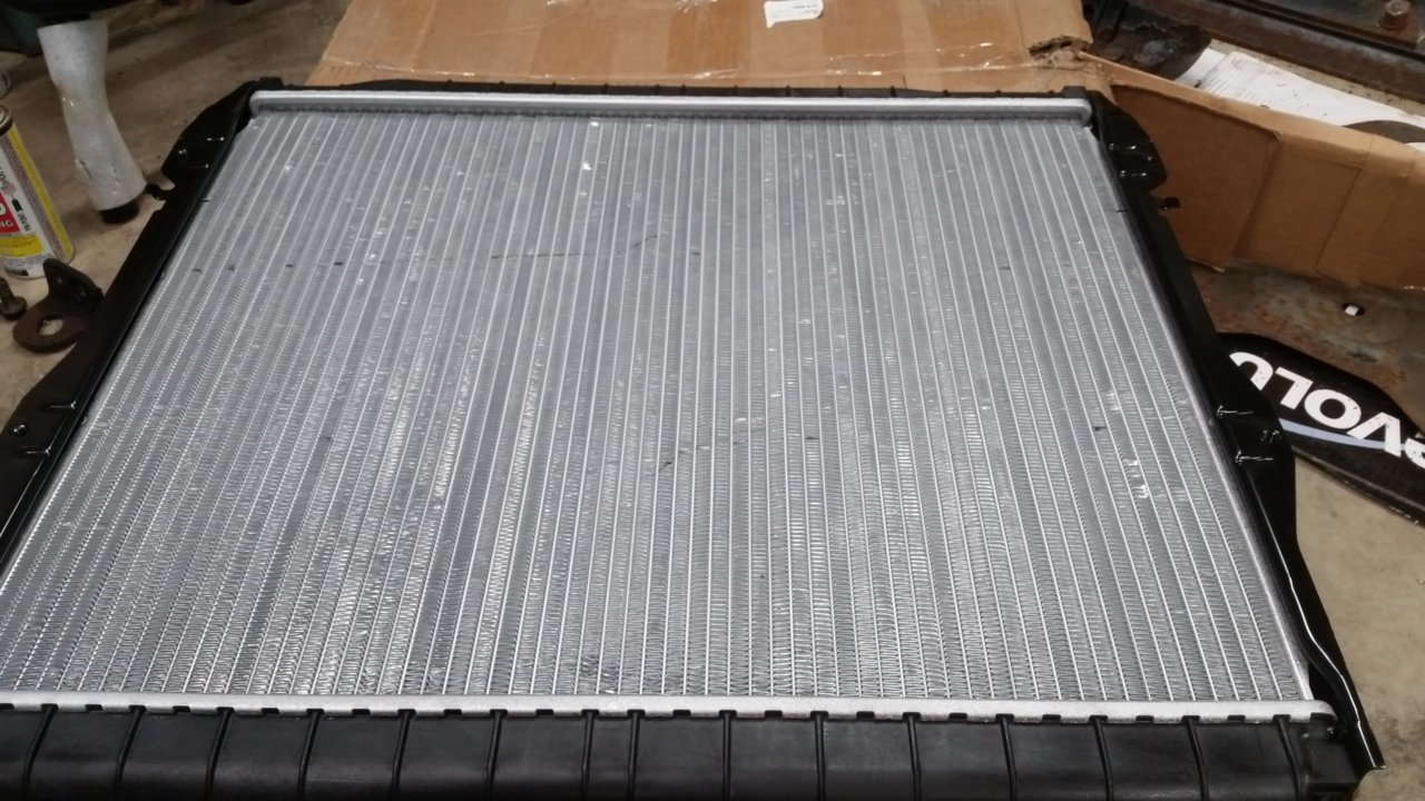

    Hello,
    I received a new OEM radiator (164100C032) for my 2004 2.7L Tacoma. The radiator has several bent fins but otherwise I think it is OK. I cannot help but feel upset that it is not perfect ... but being new it's clearly better than my ~17 year old original radiator. It has a manufacture date of September 2020. It seemed to be packed well. I imagine that the damage occurred in shipping.
    The fins do not affect the radiator's ability to hold fluid, right? They are used to allow air to circulate between the tubes that contain the coolant? Should I just use a small screw driver and bend them back?
    Here are some pics to get the conversion started:
    20211121_154804.jpg 20211121_154831.jpg 20211121_154838.jpg20211121_154904.jpg
    I think I should be OK but again I would appreciate some thoughts on the topic. Thanks as always!

    Correct, the fins don’t effect coolant capacity. They act as a heat sink. Allowing the radiator to cool more efficiently. A few bent fins won’t make a difference.
    You’d be lucky if a new one was any better. I’ve seen them the same way or worse right out of the box. I see no issues there. I personally wouldn’t even try straightening them.

    Doesn’t look bad at all; that is just the reality of handling and transportation. Straighten them if it bothers you, but I’d just send it.

    You can straighten them with a screw driver or fin comb. The passenger side fins appear to have been adjusted when the core was build. Probably had a couple lines of tubes that caused a bow and the assembler bent the fins to get the side straight.
    Personally, I wouldn't worry and run it as is.

    i've never gotten a perfect radiator.. dont over think it. just run it

    If you want to straighten the fins, please do not use a screw driver. Use an old credit card. Reason, the screwdriver could damage a coolant tube with a simple slip of control.
    The fins are thin and soft. Very ease to reshape.

    Leave em alone. It'll look worse than that in a year anyway
