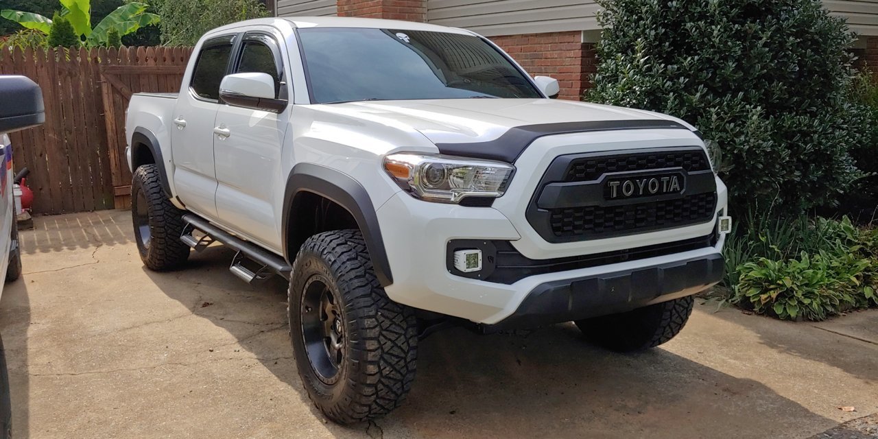

    I have run the 285's on both my last trucks, a 2006 Frontier and now the 17 Taco. Love them. I honestly don't notice any negative effects on road or off. And they look fantastic.20190812_165543_HDR.jpg
