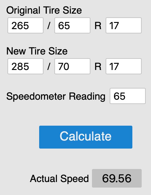

    Same here. I just know that at highway speeds my actual velocity is approximately 4mph over. GPS speed keeps me honest.Screen Shot 2019-09-09 at 5.41.28 AM.jpg

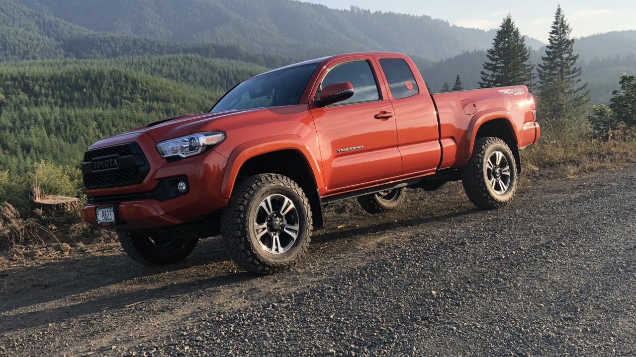

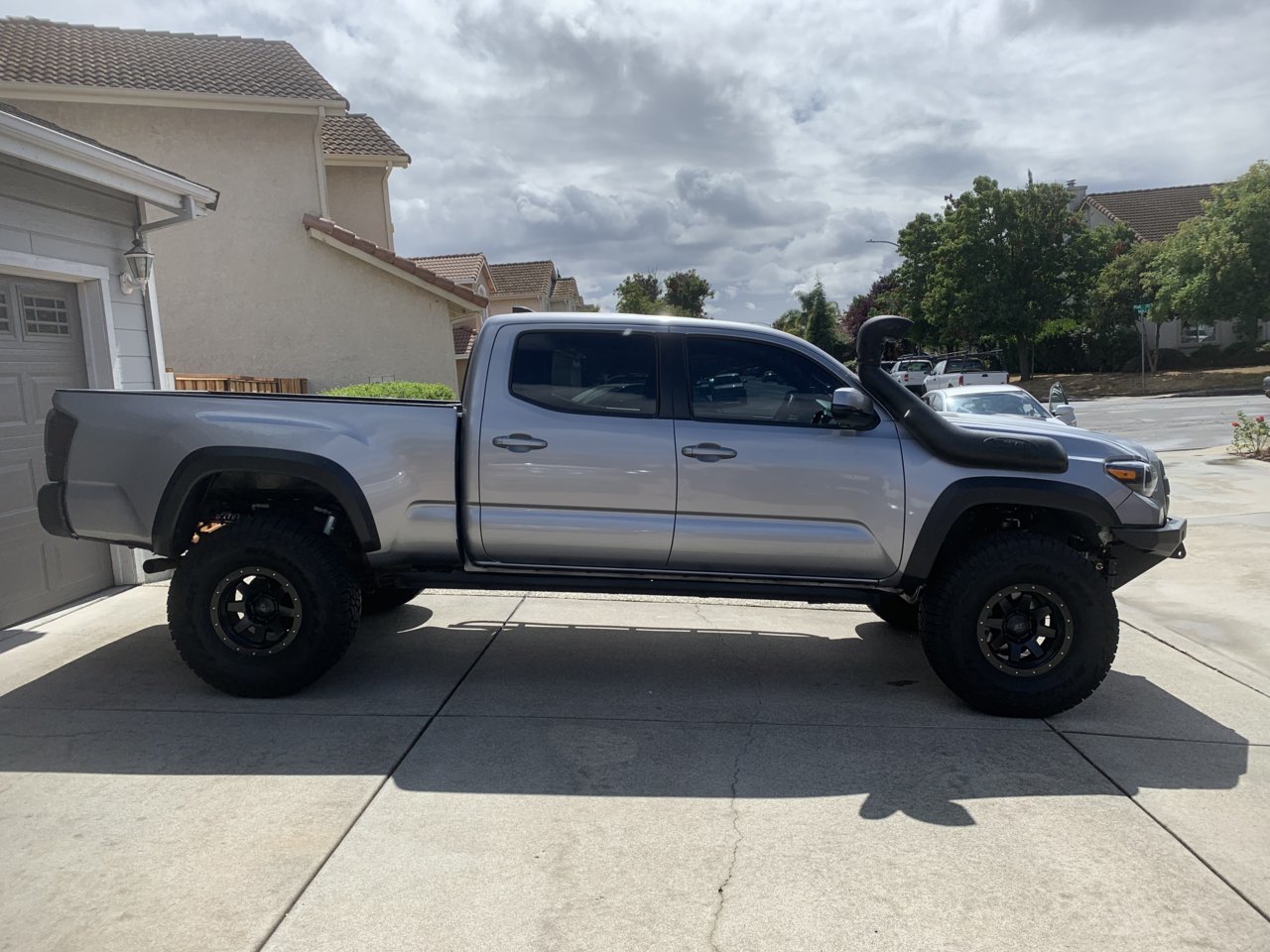

    Our trucks were meant to have bigger tires on them. Especially since you have a long bed, it makes your truck look like it had skipped leg day. 315’s or 35’s. Hell, even 37’s if you wanna do a lot more chopping. 897F6526-4816-4CB6-9483-DECE1800A5EE.jpg

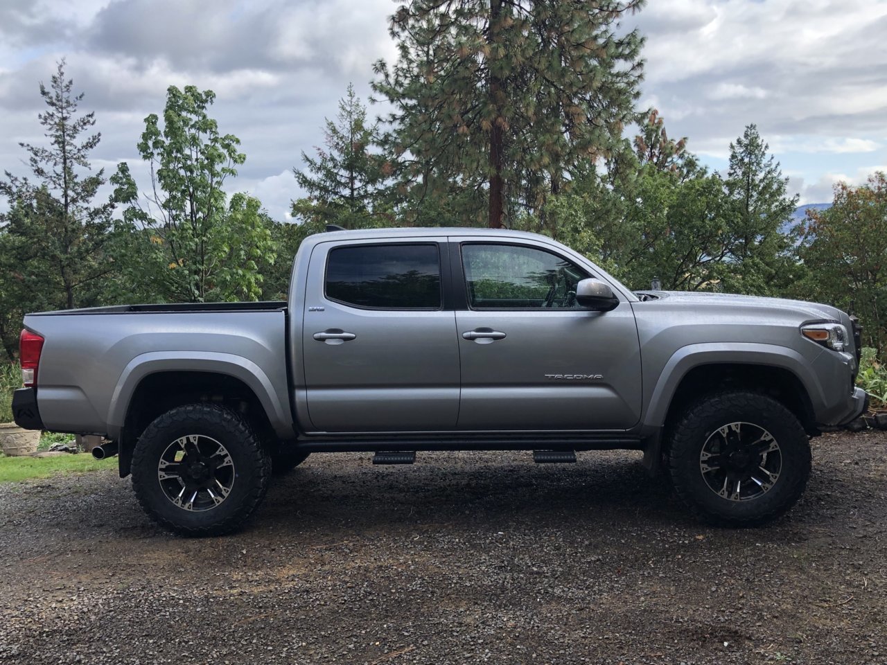

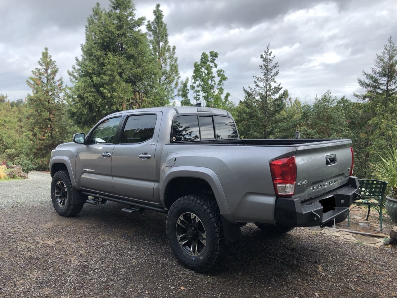

    I went from 265/70/17’s to the most popular choice for tacoma’s according to my local tire shop, BFG KO2 AT 285/70/17’s. I got a 2” lift to accommodate the taller tire.
    Like em!

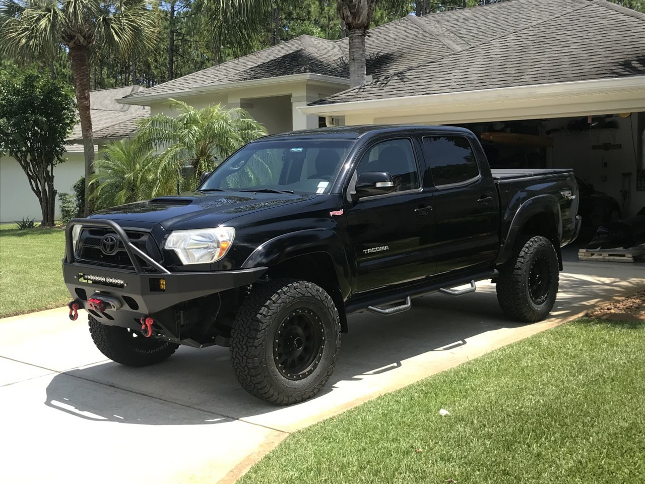

    285/70r17 provides a 1” increase in height over stock 265/65r17. I have 4” of lift and the 285’s lift the entire truck one more inch. Wife parachutes out and uses a rope ladder to ingress.

    Nice looking truck...

    Thank you! I love it too.

    What kind of bumper is that?

    That’s one of the last Mobtown Offroad steel bumpers. They do the hybrid (tubular) bumper now. I love this bumper though the reasoning for stopping production may have been weight reduction of the hybrid.

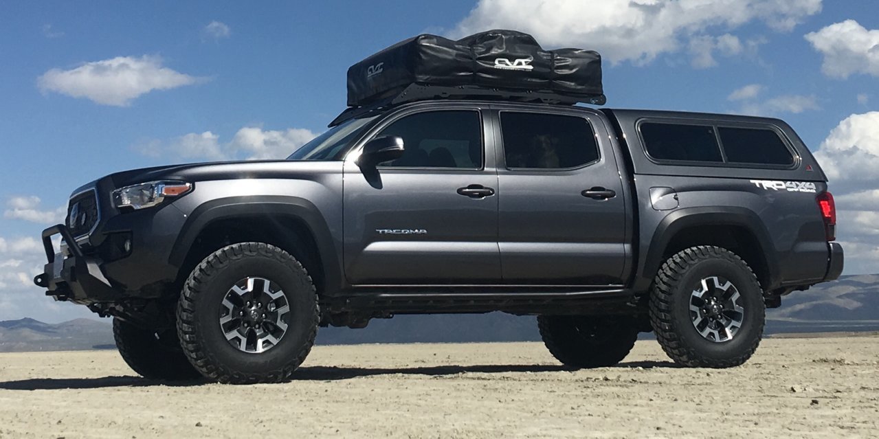

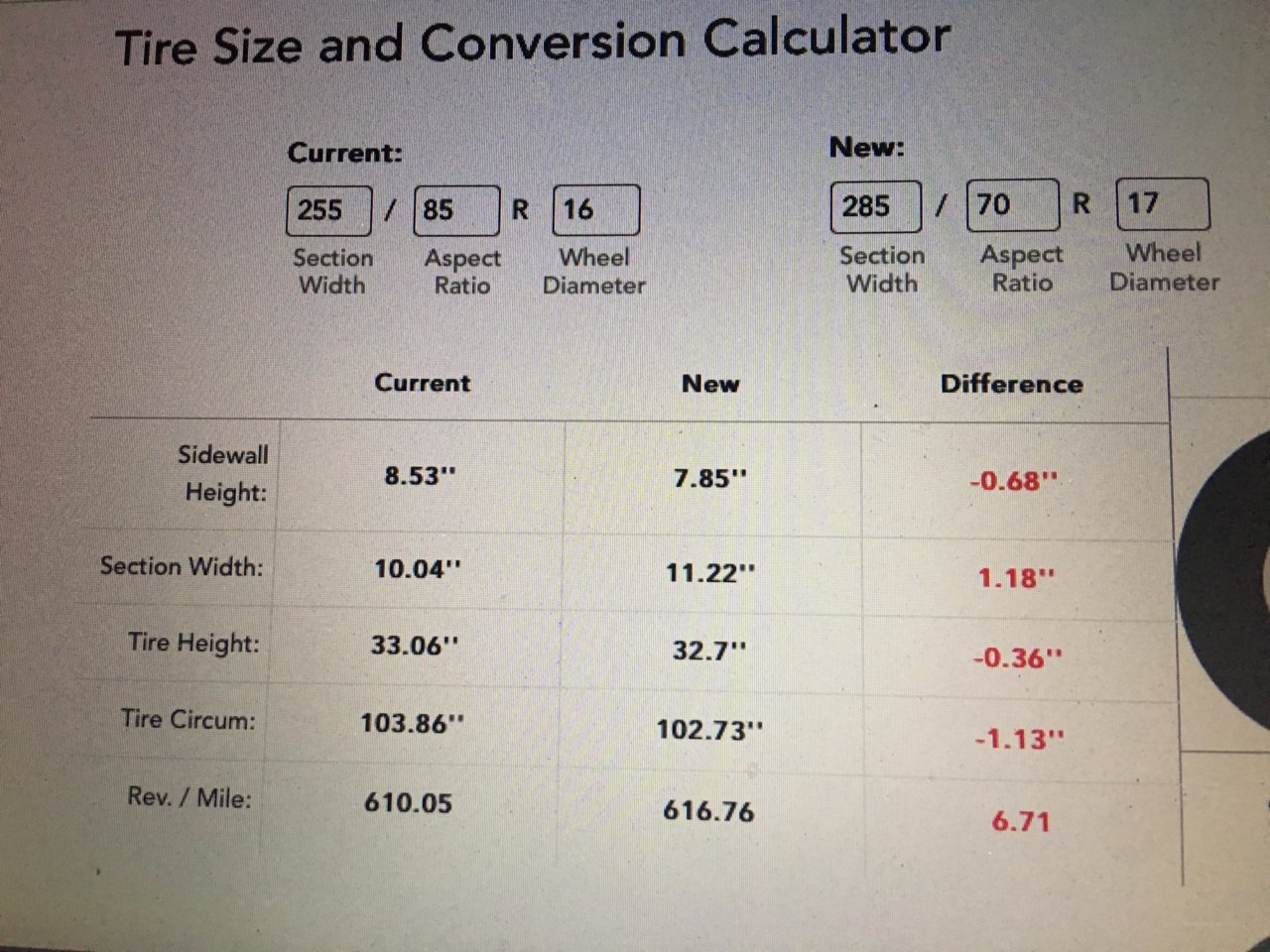

    These are 255 85 16 BF Goodrich KM3
    3-1/2" inch ICON lift..no CMC (as of yet) you may or may not tell...this is fully loaded with shell, carpet kit, camping equipment, rock slider, winch and winch bumper. It's heavy. Off road, front tires will rub when impacting holes or rocks at moderate or high speed. Slow crawl or slower travel on forest service rds okay
