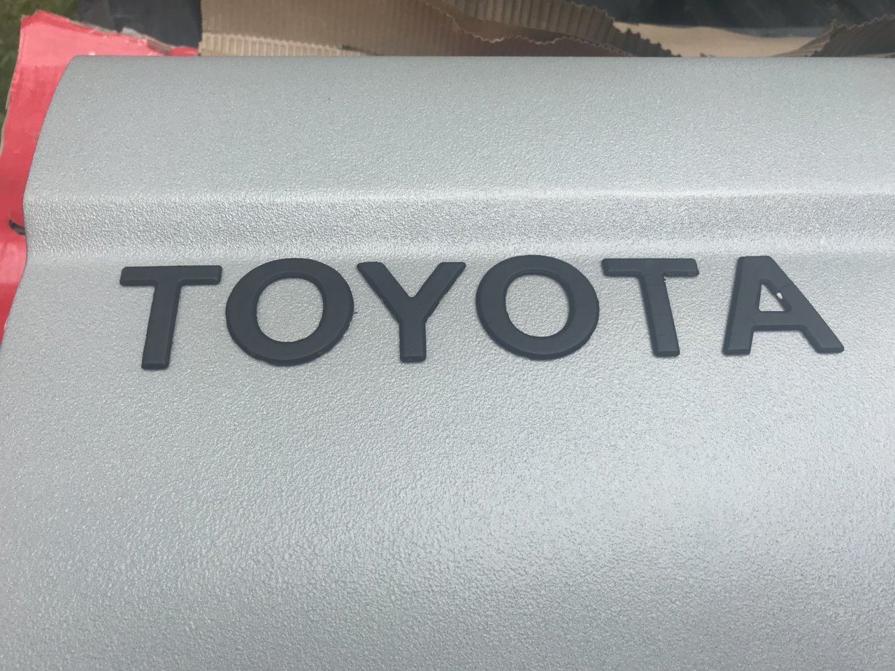

    Actually, that is Lunar Mist color, although in that photo it appears almost white. I would almost call it a "cement" color now, as the liner absorbs the reflective qualities of the color you add. Here is a better example of the color:

    lol, my bad, "Lunar Mist"
    I knew I was gonna be corrected :p I thought it might be more of a silver

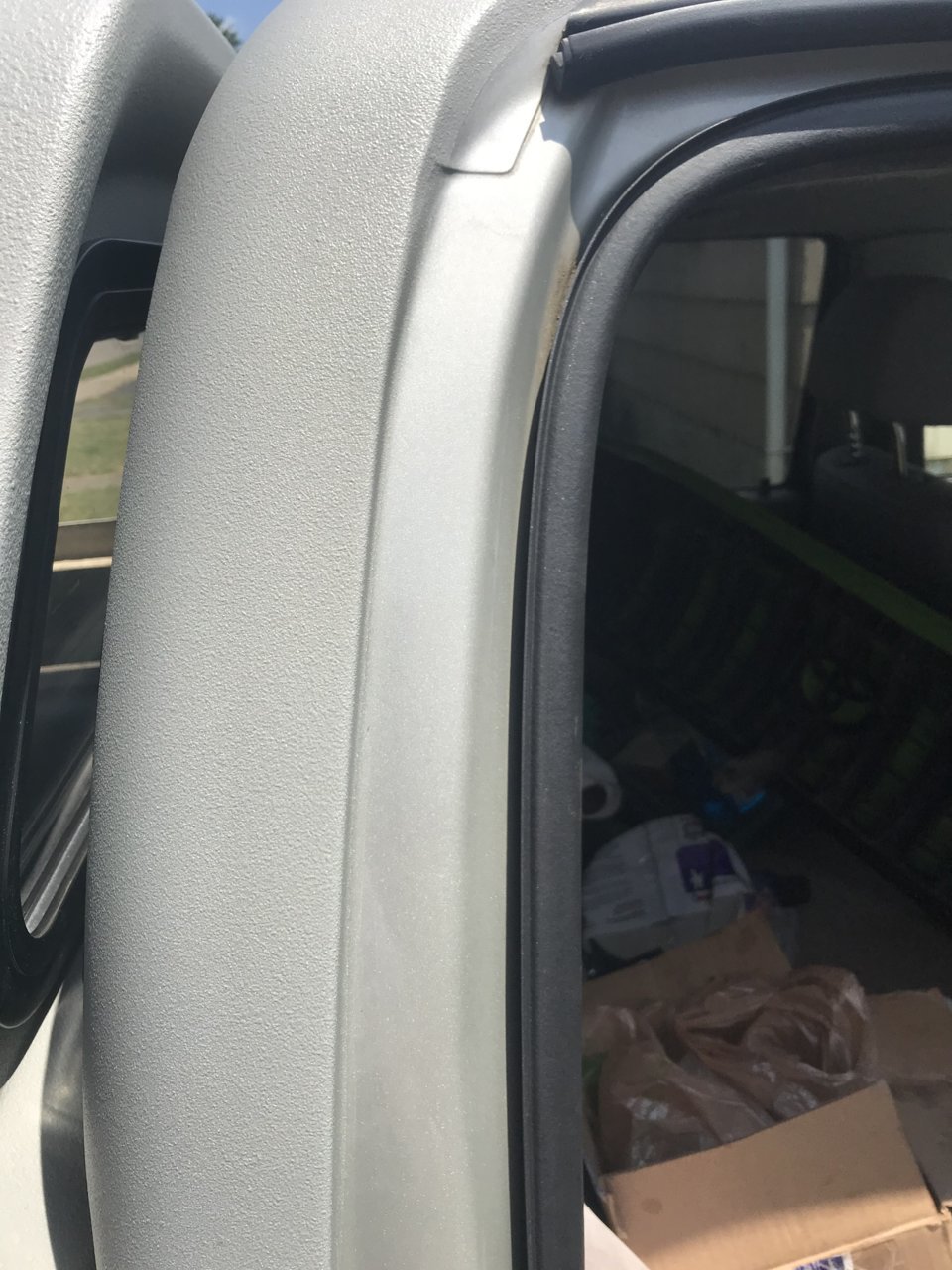

    Here is a good comparison between my factory silver (Lunar Mist), and the Raptor Liner tintable, using that same paint code to tint it.

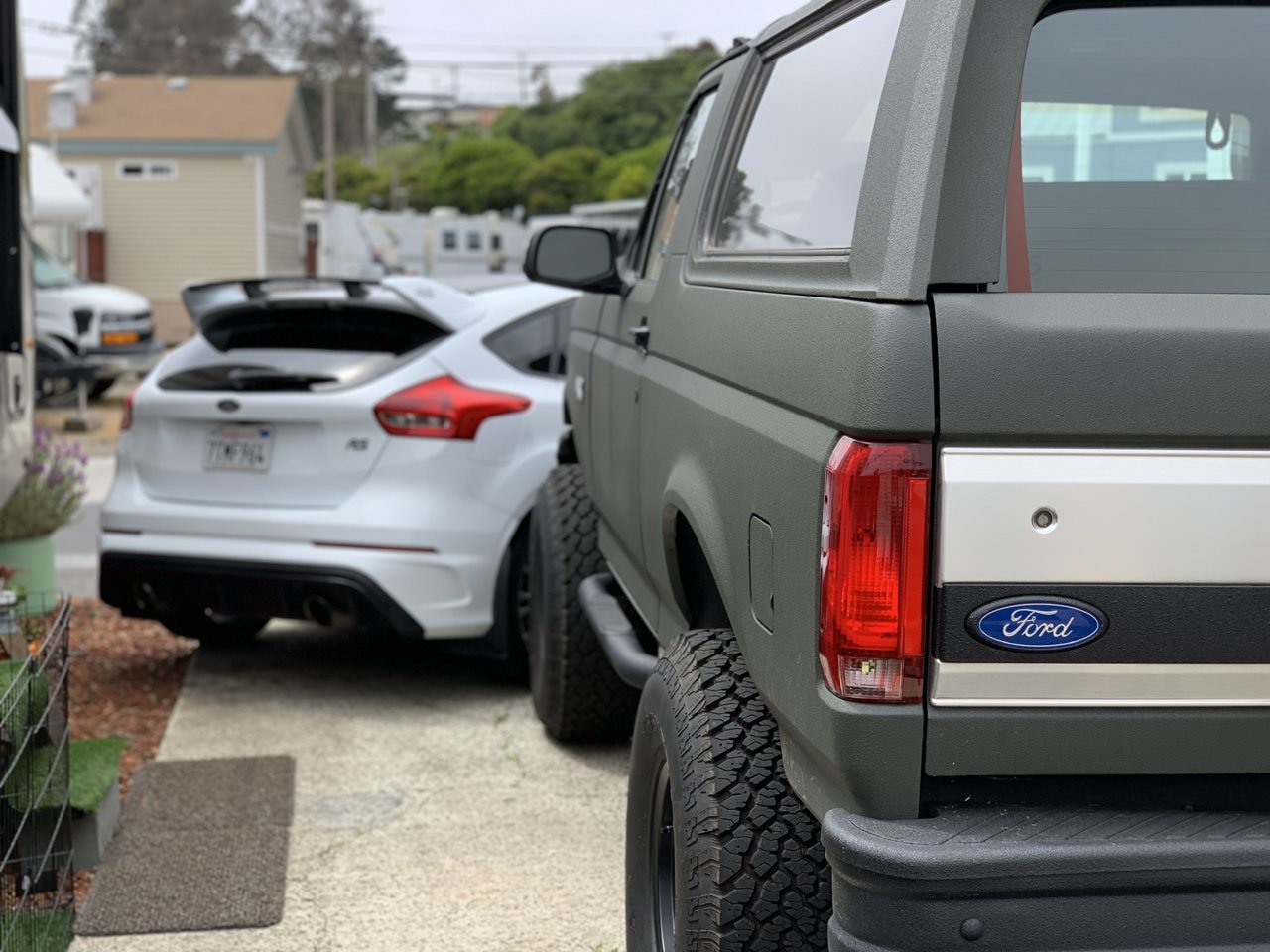

    That’s sweet :thumbsup: when I rough my paint up a bit I think that’s route I’m going to go as well. When I did my bronco I spent nearly an entire week stripping it all down inside and out so I could do the tub, jambs, everything (even did the interior like dash and door panels lol). It came out great, but I think I’ll just stick to the factory color and save myself a few days.

    I wonder how the reflective quality would fare if you put a urethane clear over it...maybe with some pearl or flakes... Somebody's got to have tried that.

    I have done a bunch of research about pearl and flake in a liner. Pearl, from what I understand wont work bc the reflective particles are too small. Flake is something that I've seen before. Mixing the flake with the liner wont work, the liner builds millage too quickly and will envelope 90%+ of the flake rendering it useless. What I've seen done is spray the liner and while its tacky still spray the flake over it, like mist it lightly. Havent done it myself but it looks cool in pictures.
