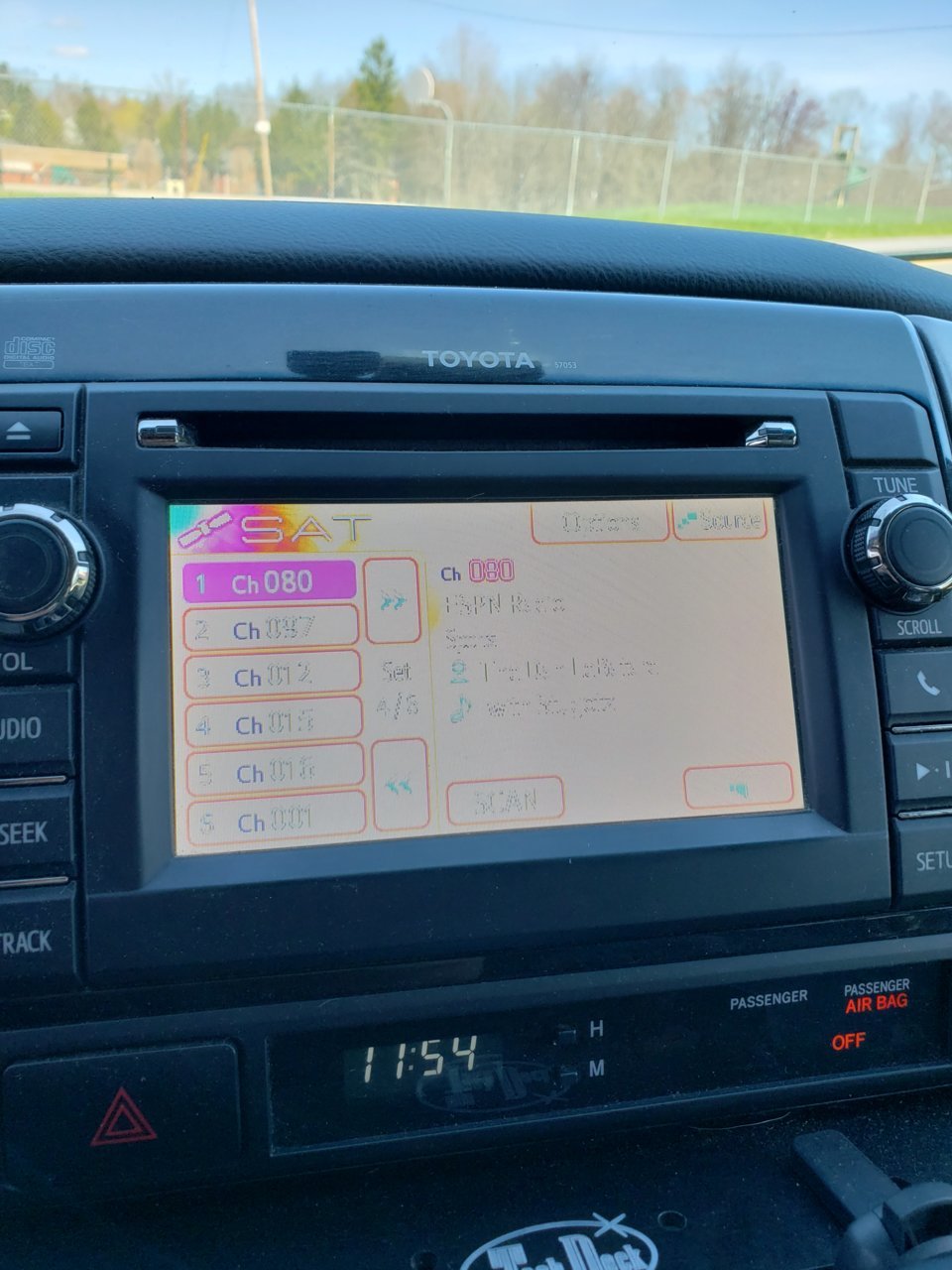

    I have a 2013 Sport with the non JBL stereo.
    A few months ago it started giving me a white out screen on startup, and lasting a increasing amount of time before it goes back to a black background like it's supposed to be.
    The biggest complaint for me is that I loose the use of my backup camera as the screen is white out. I backup to trailers alot so that's big to me.
    I could find another OEM stereo, but how much are people going to charge, and how long will it last for?
    So I've considered replacing the stereo with aftermarket. 15yrs ago i was into aftermarket stereos, but this was when they were way more basic. I have only ever been in a few vehicles that had a oem radio with android auto or apple car play.
    Being able to display Waze on the screen is really the only thing I personally see as a need from it, otherwise I have no issues with my current stereo.
