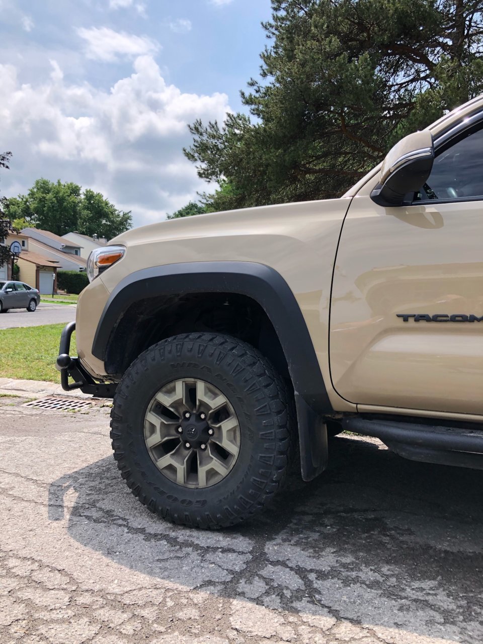

    - 2/1" Bilstein 5100 Lift (similar to OEM TRD Lift)
    - OEM (Plasti-dipped) rims. 265/75/16 Duratracs

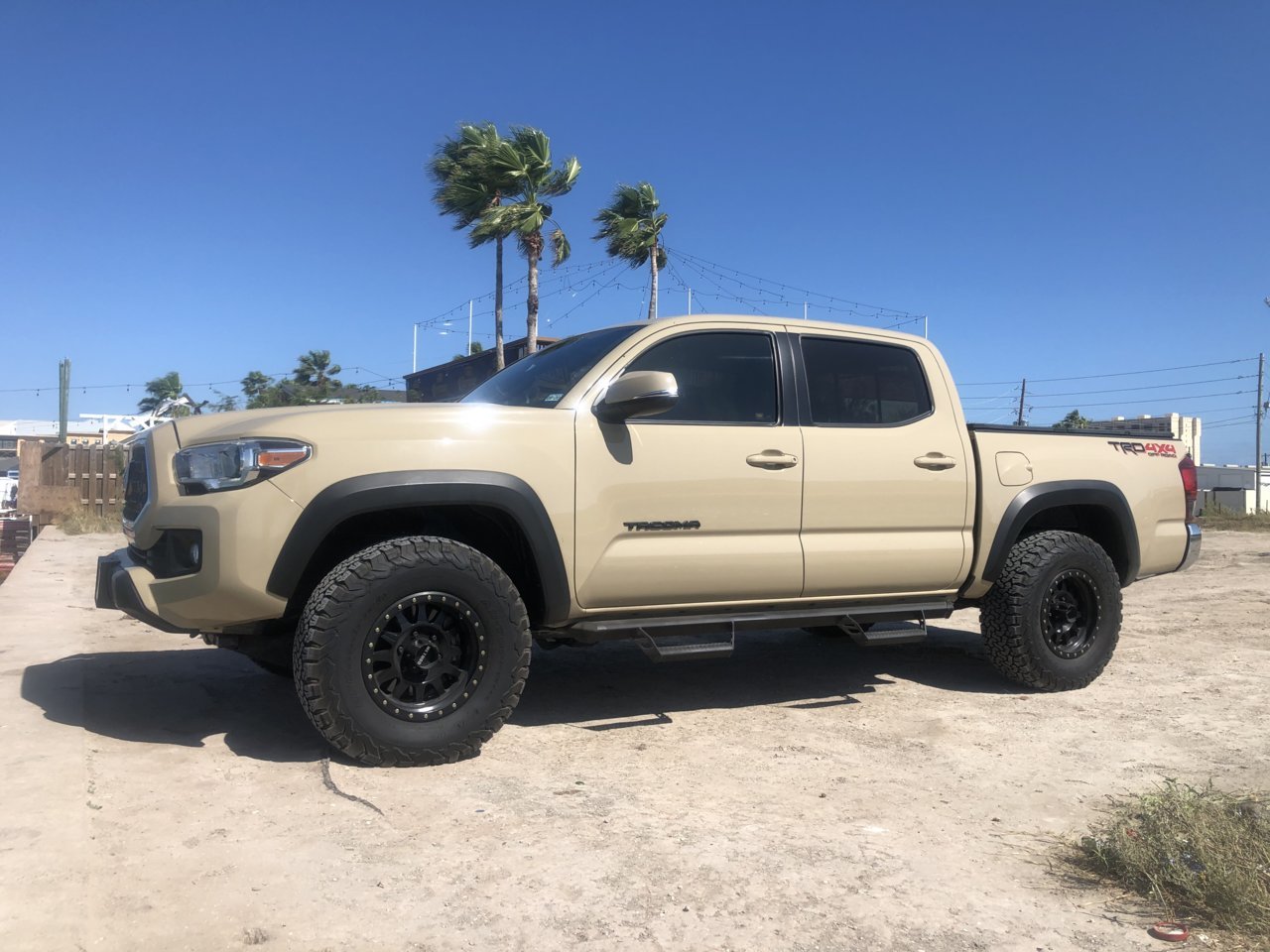

    The reality is, these trucks are fully capable for moderate offroading right out of the wrapper. But I 100% agree with what was posted above, start with wheels and tires. It'll give you the look you're going for and a better tire offroad. That's the route I went (265/70/17 Wildpeaks on FN Pro FX wheels). The truck looks fantastic. More agressive look, with a tad bit of poke and more grippy in the elements.
    If at some point I find myself doing more aggressive offroading...maybe I'll lift....but I really doubt it.

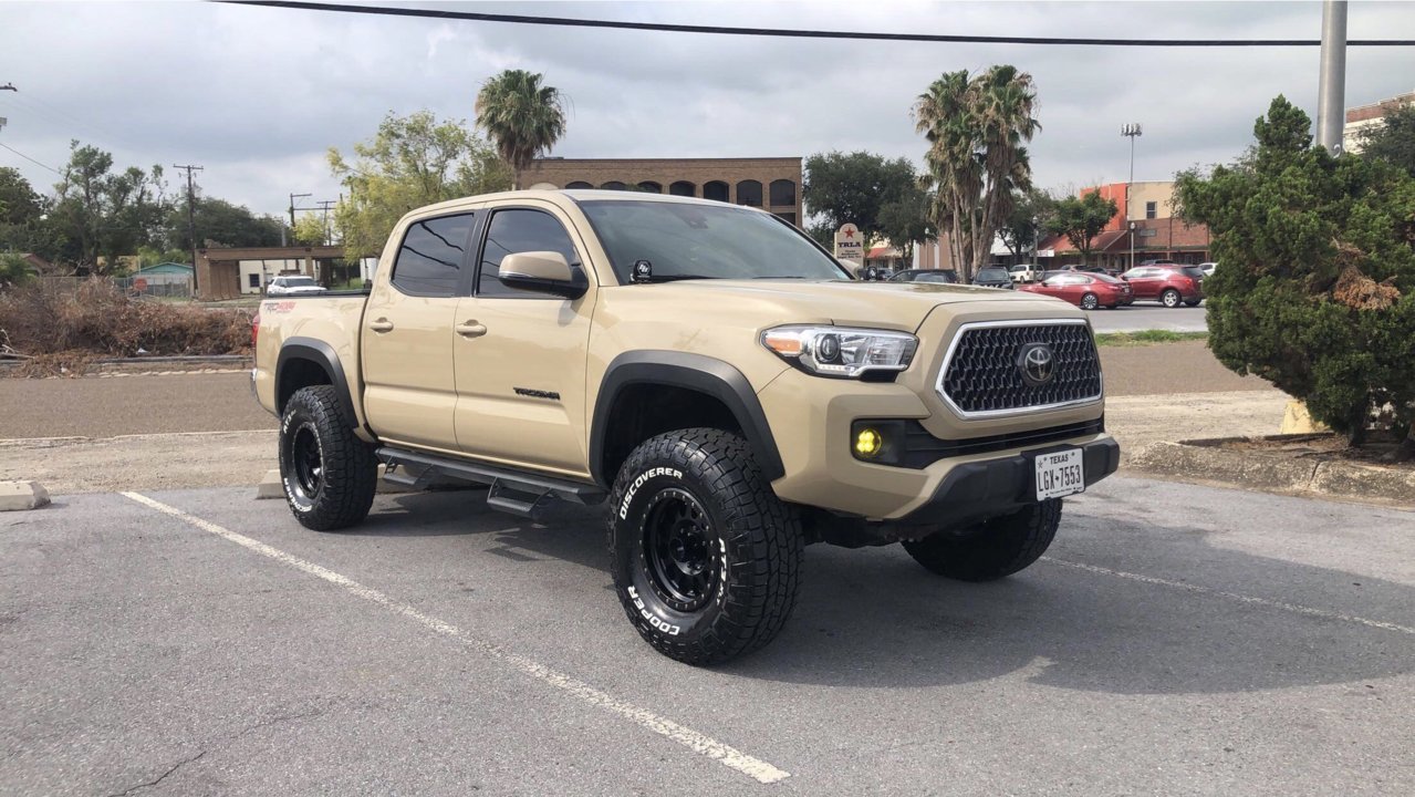

    Cooper AT3 XLT 295/75/16 Method Double Standard wheels Eibach Pro lift Baja Design Fogs Baja design Ditch lights W/ Cali raised Lo pro Brackets WrapArmor Hood Decal
    Eibach coils and shocks set on second notch. 1.5” blocks in the rear. 295s Cooper Discovers on 16” Method Wheels. Ride is stiff but over all I love my set up. Also, no trimming but will rub a little off road.
    Prior to lifting I ran 265 BFGs on the methods for about 2 years.

    no trimming on 33s and you only think you will have a “little” rubbing off road? Shirley you can’t be serious? :bananadead:
    edit: I think those tires are Discoverers, not Discovers…it’s written in bold white letters on your sidewall

    Well if you only go in a straight line it certainly won't rub! I had 285/70/17's with 16x8.5 0 offset wheels on my last rig (11 4Runner) with eibach springs and JBA arms. I had to do the body mount chop and trim a lot of plastic to make them never rub. And that was almost 3" up front. I know different truck but very similar front end and tire clearance stock. Pretty much every one of the now 18 Toyota trucks I have owned since the early 90's has been lifted. But honestly the places I usually frequent for off roading I can do no problem with nothing more than a decent A/T tire these days. I may lift this one like an inch just to make a little more scrub room for installing some wheel spacers for a slightly more aggressive stance.
