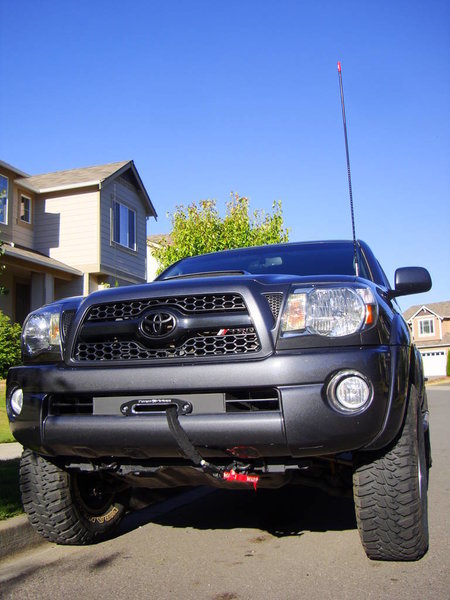

    Since you live in CO, there's one more thing to consider... If you get synthetic line, be sure to keep it covered, especially in winter. If you've got a slushy day, the synthetic can freeze into an ice block. With the steel, you can run your winch in reverse to unspool it without damaging the strands.
    Here's a pic of my steel line setup with a Hawse fairlead:
