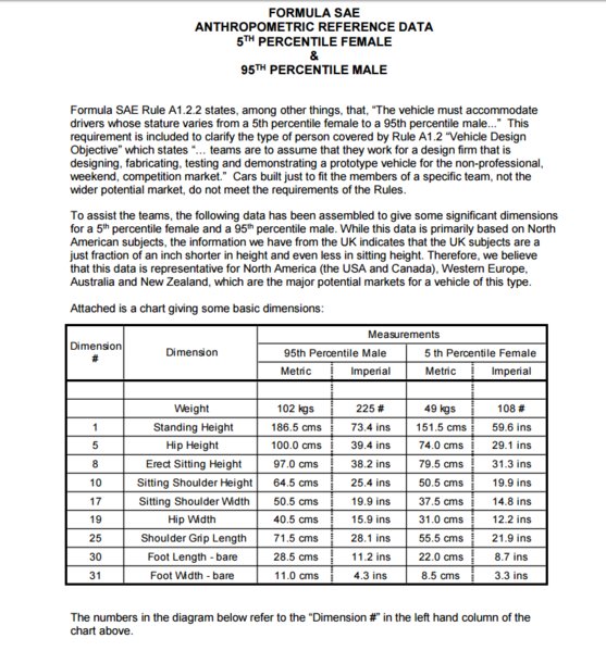

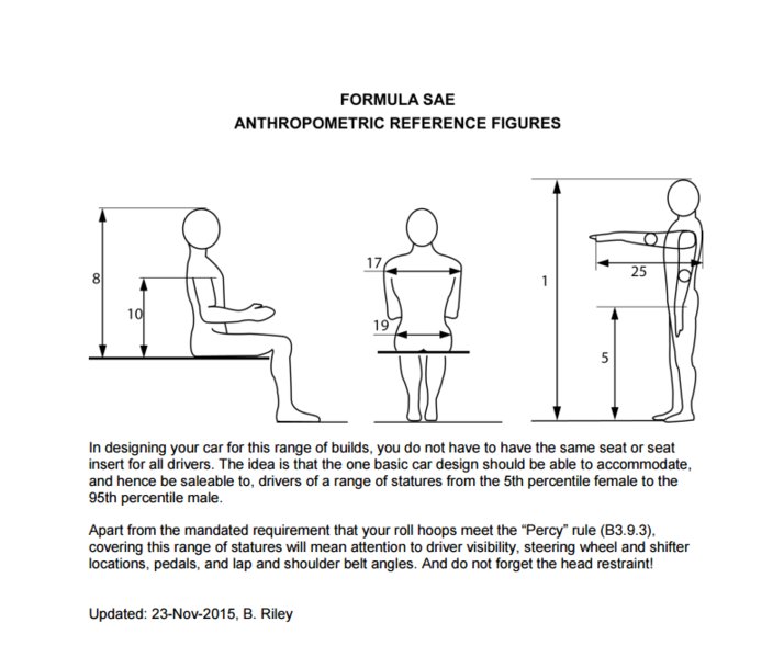

    Here's some quick reference info on seating H points in car design. I'm sure Toyota uses this also, but seems like they haven't changed much to accommodate a better lower seat adjustment, even if it were with manual adjusters.
