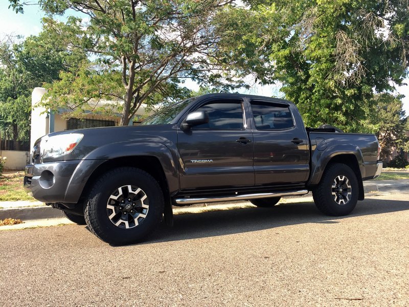

    I recently replaced my stock 17" 2011 SR5 wheels with 3rd Gen 16" off-road wheels (16x7). Does anyone know if 255/85r16 tire (tall and skinny) will fit this wheel with a 3"- 4" lift without spacers?IMG_0018.jpg

    I would have to say yes. 255 are skinnier than the stock tires and the lift should make room for the taller tire.

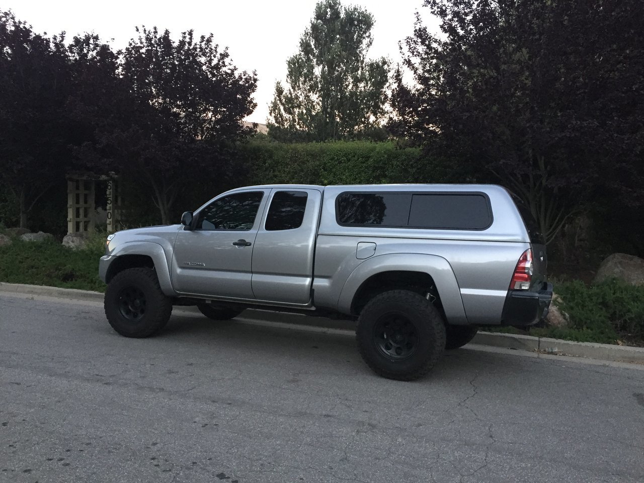

    Im pretty happy with the 255's. They definitely dont look skinny on a 8.5" wheel. Kinda curious how they'd fare aired down though IMG_3030.jpg

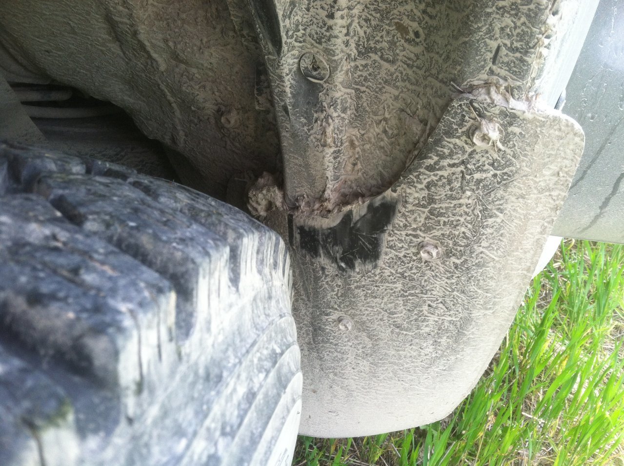

    The comment above about stock wheels is correct.
    As for airing down I run mine at 10-15 psi fairly often when wheeling in deep snow.
    Also, I jumped my truck recently and here's all that rubbed. Nothing else rubs.
