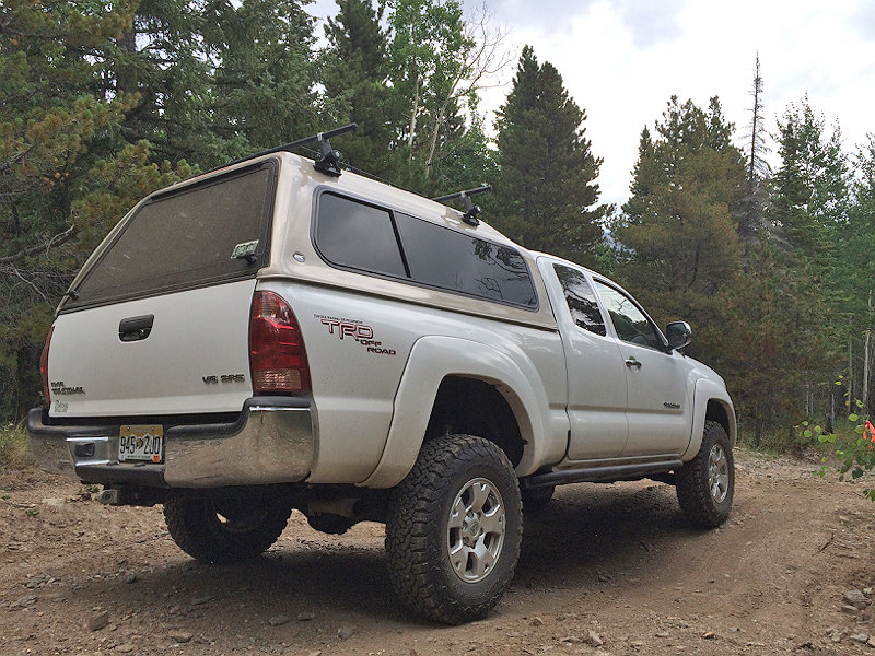

    Guess the question is going from 30.5 x 9.7 (245/75R16) to a 33 x 10 (255/85R16) tire just a "little" taller and "no wider"? What do you want @LittleLady808? A 255/85 is going to really fill out the wheel well on your truck, especially on stock suspension. Won't have much room to flex. I have about 2" of lift on stock rims and Camburg UCAs and there's room for my 235/85s to work without rubbing anything but not tons.

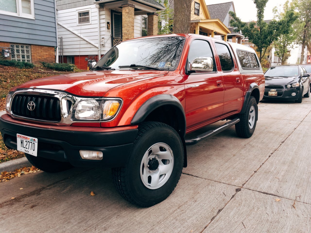

    I have a 2" leveling kit on my truck and was thinking of getting a slightly taller tire rather than wider. I like my wheel spacers so thought maybe I could keep them and see if a taller but same width tire was possible. I don't want to go with 2 big a tire though because I don't think my 4cyl could handle it! Lol
    DaveInDenver[QUOTED] likes this.
  19. Oct 31, 2017 at 3:52 PM
    #19
    Danno1985
    Danno1985 Well-Known Member
    May 2, 2017
    #217999
    325
    Milwaukee
    2003 Prerunner TRD Off-Road (RIP)
    235/85r16 here as well. Seems like this size would fit the bill.A83108EF-A698-4609-B342-BFE1823D912B.jpg
