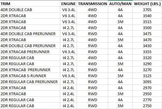

    your 94s curb Weight was 3900?
    interesting… found this for 1st gen Tacoma’s
    I need to take mine to a scale

    #18
    truckmike26
    truckmike26 New Member (2009)
    Jun 12, 2009
    #18374
    283
    Toronto
    '21 DC TRD Off-Road, '94 Pickup (Hilux) V6/Auto 4WD
    The pre-'95 IFS Toyotas have a heavier frame and upper control arms to support the torsion bar suspension plus recirculating ball steering (iron steering box, no aluminium rack). 31x10.5x15 tires on factory seven spoke steels, V6, automatic and dealer-installed A/C. You know, I could be wrong, I'm just going by memory from magazine tests and brochures from many years ago. Now I'm curious. I think a trip to the municipal scale with the old truck due as well.
