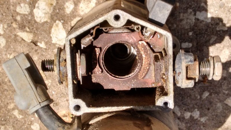

    Mission successful. I removed the starter and opened up the solenoid and found exactly what I thought I would. It had mud all over everything, including the contacts which was intermittantly preventing the plunger from completing the circuit to activate the starter motor.
    I cleaned the contacts and reassembled everything and it appears to be fully operational for zero out of pocket expense. :yay:
    Go me!

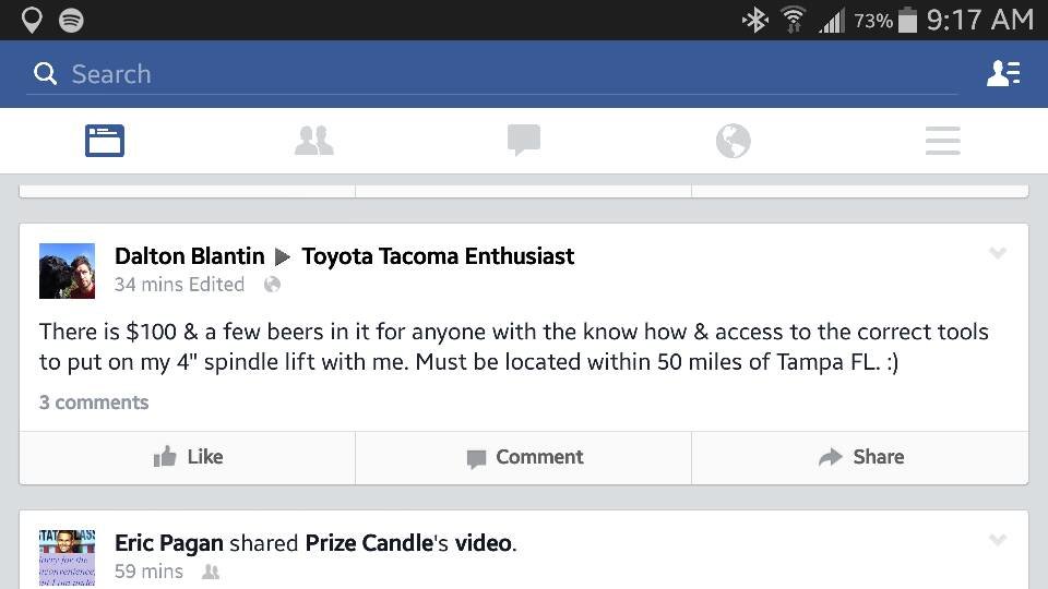

    I just told Dalton to post in here. Y'all show him some love.

    Hello, ^^^^^^^^ That's me. I figured I should finally come on board with Tacoma World! So, I have a 4" Spindle lift coming in the mail as stated above, if anyone has any interest I'm all ears, or - eyes.
