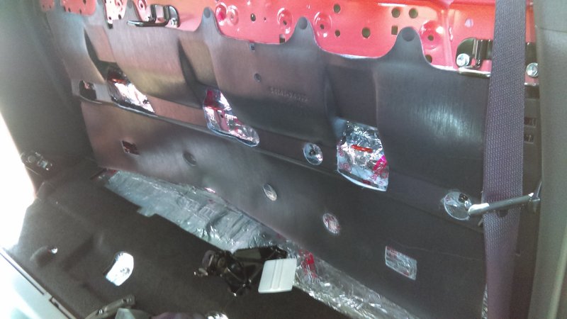

    The rear wall n floor got some xtra treatment... Two layers, some spots got three! Especially towards the drive wheel...
    The passengers side rears got it thick...
    ...and the "original" sound barrier goin back on!

    It works. I can tell just by riding around in the neighborhood. Its definatley quieting up the cabin.
    No smells. So far so good.
    Its basically aluminum foil glued onto some 1/8" thick material. Foam material.
    No tar lookin material or nothin...

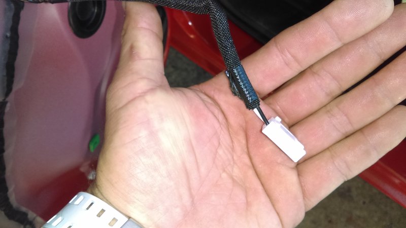

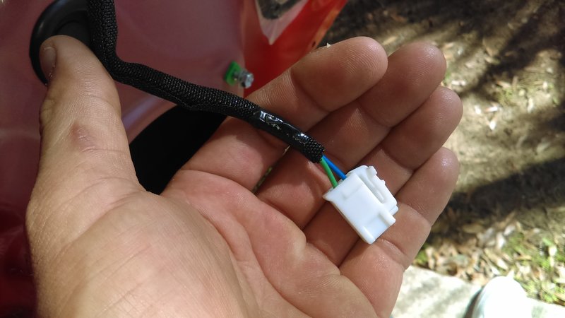

    Is anyone out there familiar with the doorspeakers wiring?
    Ive pulled out the rears and cant differentiate the polaritys...
    Nothings marked positive or negative on either one...
    My LeftRears are blk and wht
    My RightRears are blue and green
    Can anyone help me out?
    I cant find nothin online about the 16s... The mustve changed the wire colors...

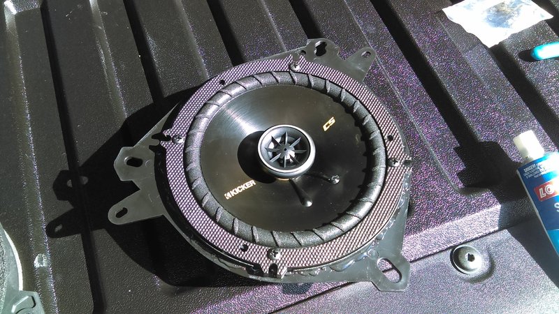

    Got some Kicker CS65s into the brackets n ready to go...

    If those only fit one way to the speaker terminals then you can identify their polarities. That is if the speaker has a polarity sign right beside the terminals.
  16. Jan 16, 2016 at 1:38 PM
    #36
    TBayRay
    TBayRay [OP] Well-Known Member
    Dec 17, 2015
    #172468
    96
    Ray
    2016 TRD offroad dub
    There were noticable markings on the speaker terminals, and they were also both the same size... No biggie.
    Took the stock speakers to a car stereo shop and they tested them and let me know the notched side of the connectors, the positive.
    Soooooooo-o.....
    LR+ white
    LR- black
    RR+ blue
    RR- green
    When I get to the fronts done I will letcha know what those are...

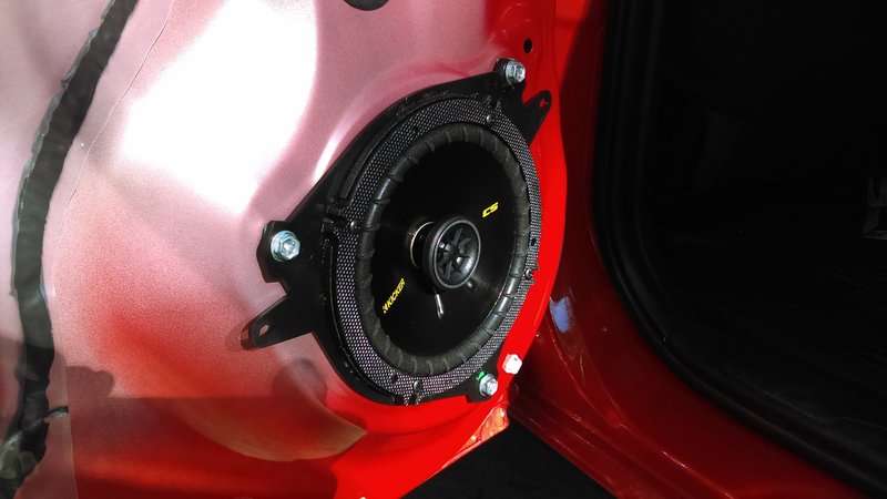

    Rear doors installed:
