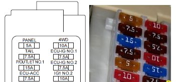

    I am wiring up a scanner, along with the red pos and black ground wire, there is an orange wire that you can hook up to the headlight fuse? in order to dim the screen for “night mode” does anyone know the best place to tap into the electrical system that would provide me with this?

    Use the PANEL fuse with an add-a-fuse.
