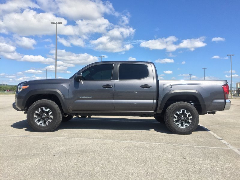

  7. Oct 16, 2016 at 5:27 PM

    IMO thats a huge difference. what kit was that again?

    Rough Country 3/1 lift level kit
    http://www.roughcountry.com/toyota-suspension-lift-kit-745n2.html
    The front is a little stiffer and the truck steers a little bit quicker if that makes sense. The back feels like stock as far as the bumps and ride. I think the shocks that come w it help a lot vs maxing out the factory shock and dampens the added stiffness of the block.
    Front rose 3.25" on either side as the rear came up 1 1/8" on either side. Truck sits perfectly even sans the "bro lean".
    If you don't mind a slightly stiffer ride and just want the look than this kit is fine.
    If you want factory like ride w added ground clearance than save them ducketts because this kit ain't for you. This is just temporary till I can get the thousands and thousands of dollars on a proper lift kit lol.
