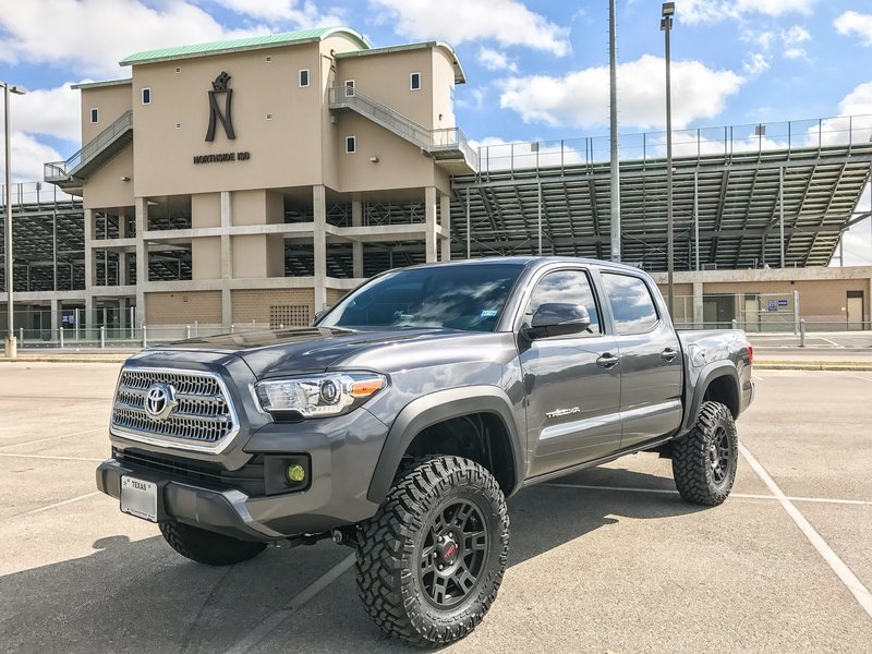

    Took the truck in for alignment. Surprisingly the caster wasn't off too much. It definitely was pulling to the left.
    Oddly enough before lift and tires, the front wheels were cambered inward. After the lift they were like that too.
    Now they sit perfectly straight and the truck almost drives and rides like stock. Still stiffer but I can put my thumb on why it drives so much better with very little adjustment.

    Any more pictures. Looks great.

    What type and size of tires?? Looks great

    265/70/17
