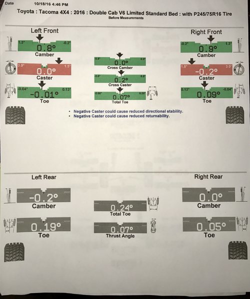

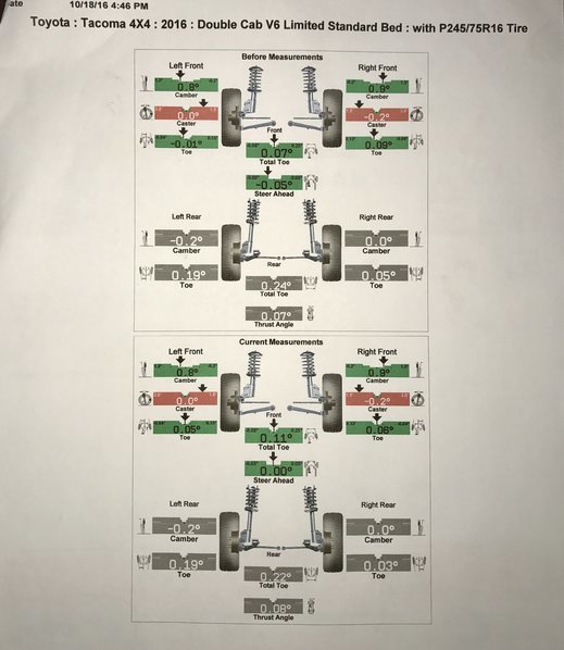

    Here ya go guys.....
    Recommended Specs
    Before measurements on top, current measurements on the bottom.
    RC Kit alignment recommendations.....

    The only thing they changed was the toe. Caster should not be at 0......

    It's just like @ZachMX was saying. They did the best they could, but ideally you want your caster around 2.5*-3*. I'm surprised your steering isn't twitchy at highway speeds.

    The first sheet I posted shows the factory specs they have on file. Now it clearly says is for a 2016 4x4 Limited. I'm totally lost now. Folks on here say it should be a certain number, RC kit gives certain alignment specs, and the alignment shop gives certain specs.

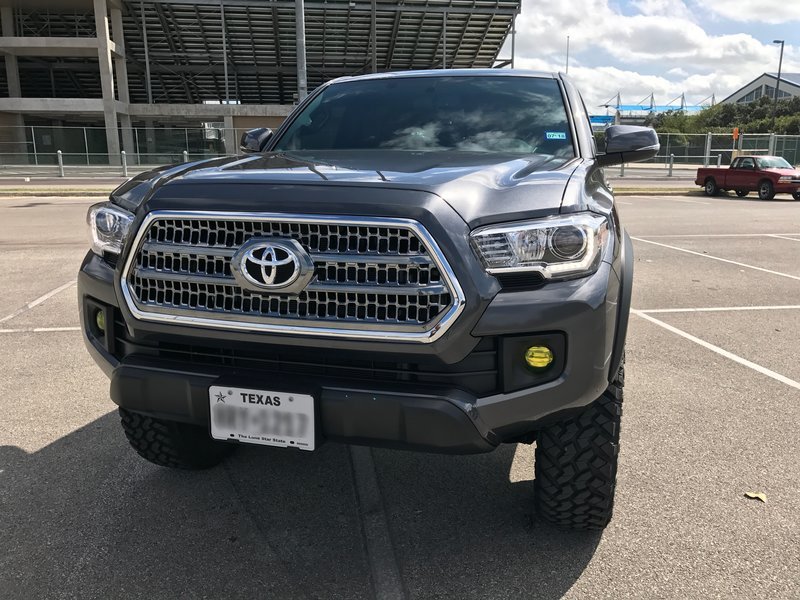

    Can you post a shot from the front of the truck?
    Aztec.Taco[OP] likes this.

    Here ya go. As close to a front shot that I have.

    That looks pretty darn good, thank you. Literally looks to be at the same orientation as the factory tires are on mine.
