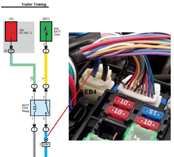

Tapping 12v power for bed - with ignition vs always on

    Guess you are a better engineer than Toyota:burp:
    Not 8awg:

    i still think 40A is way overkill going to any trailer...

    I'll go try to take a look but in the off chance someone knows, what gauge are the positive and negative wires running to the 7pin connector? I have 10 and 12ga wire available and if different will get it. will want to match the gauge.
    I have in-line fuse, receptacle, and t-tap connectors ready to go. I'm running out of decent weather though.
