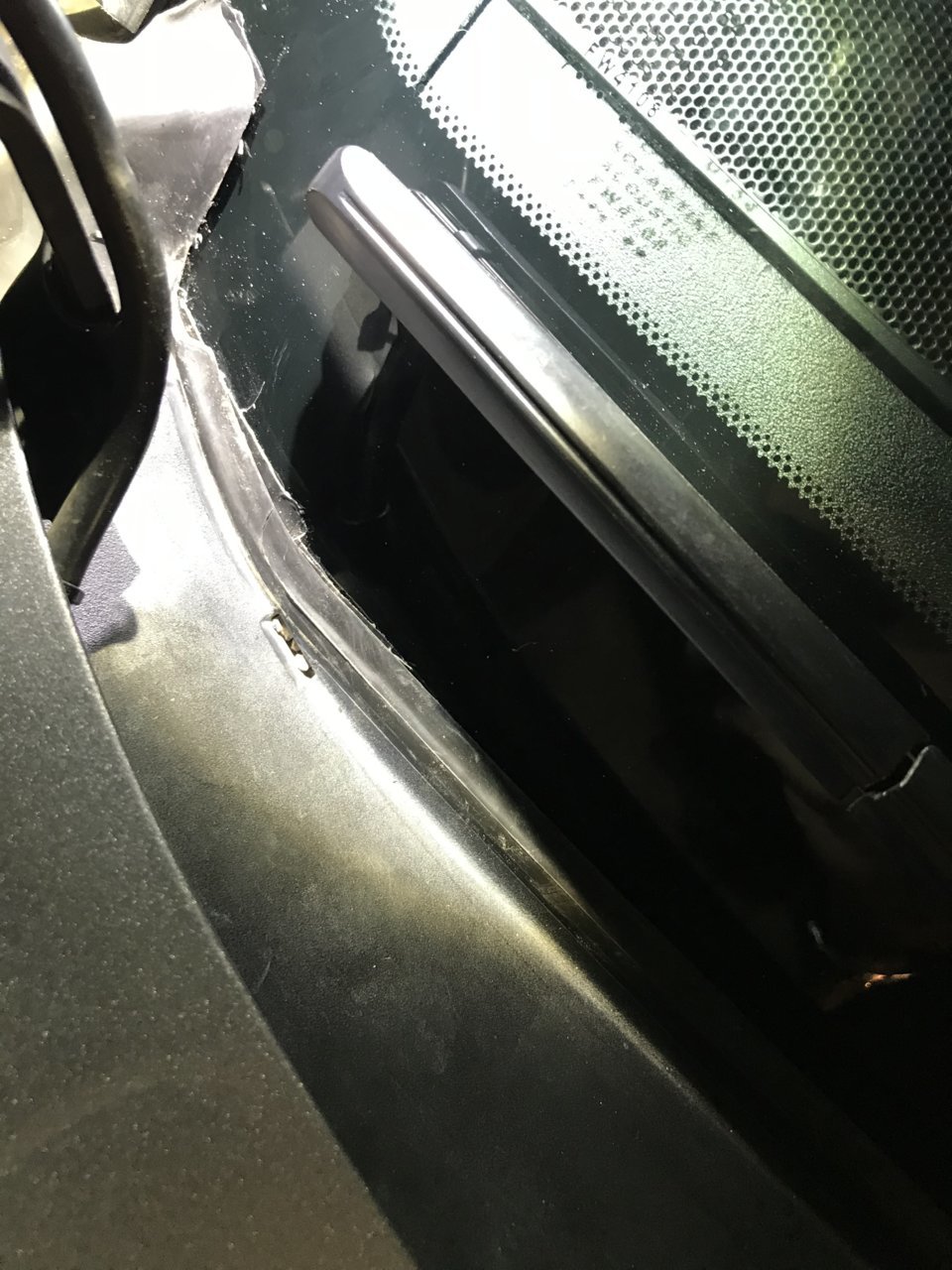

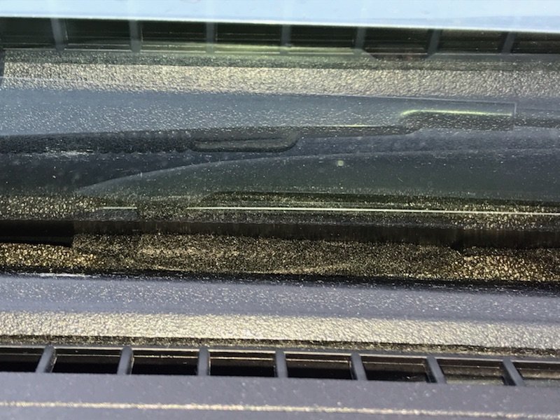

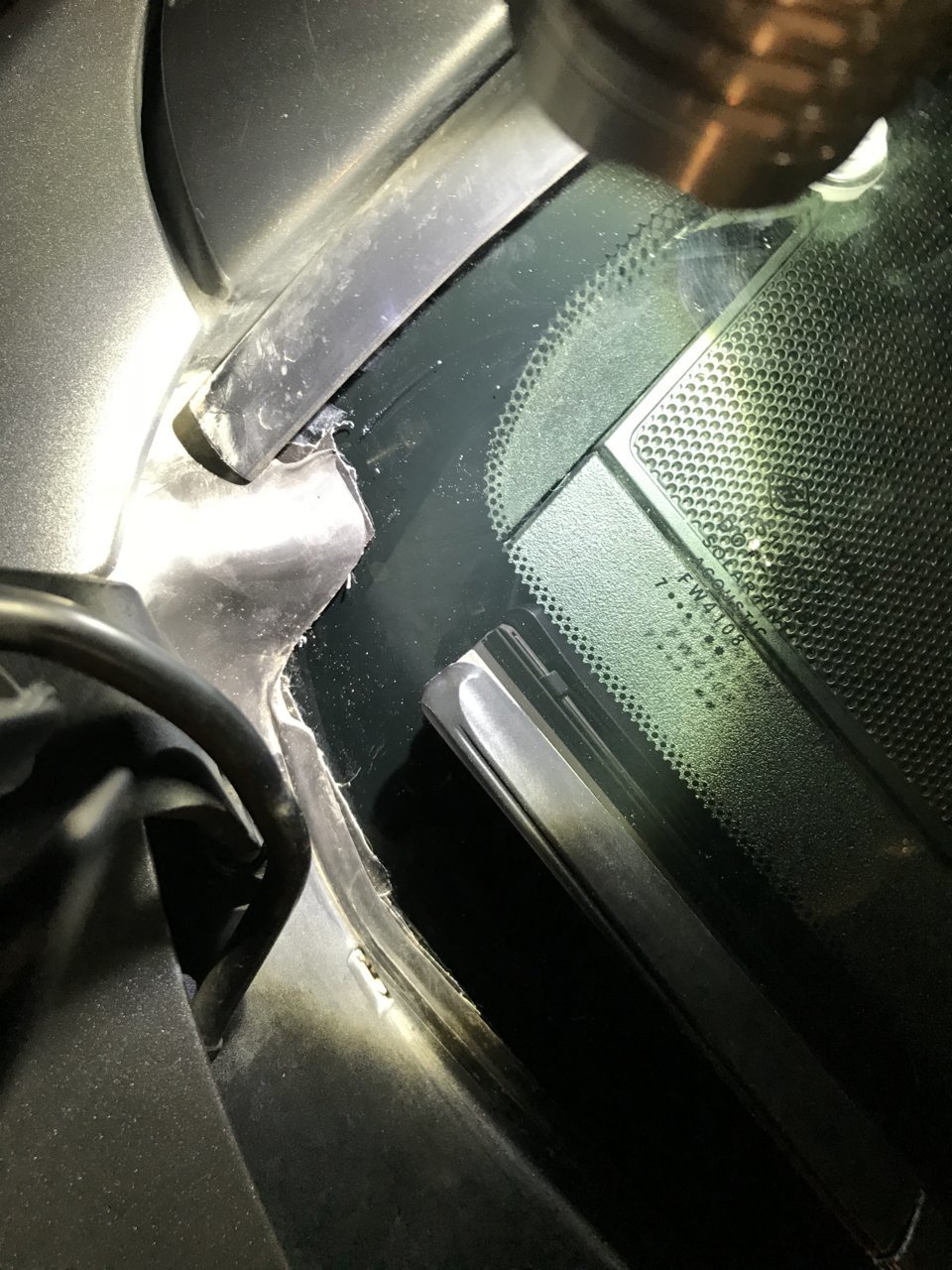

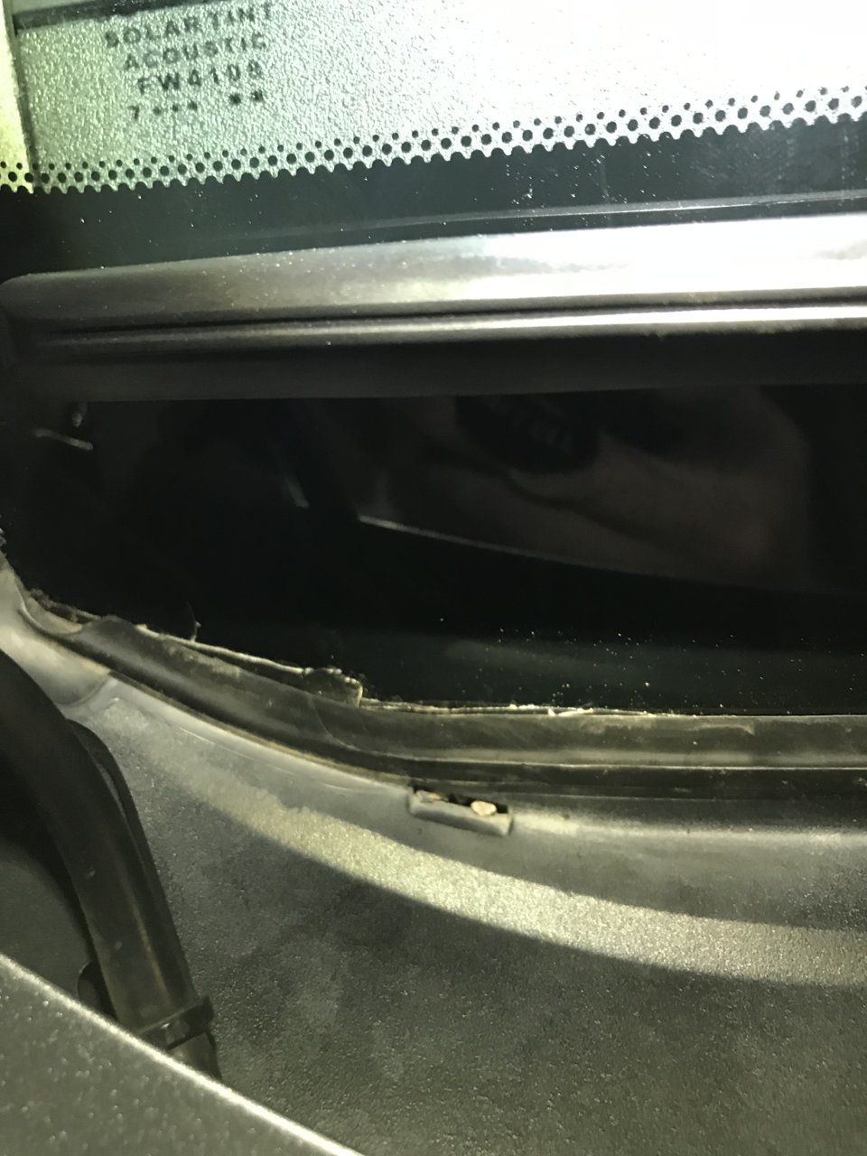

    I fixed my A-pillar rattle last year. This fall the "dash tick" had been coming back when under 60 degrees or so. It sounded like it was originating from the plastic behind the dash/entertainment trim piece, so I removed it and it still had the tick. When driving, I found the dash plastic near the right side of the windshield defrost vent would tick. It stopped when I would put pressure on the dash when driving. I stuffed a bunch of felt under the windshield, behind the foam strip that's there between the windshield and dash plastic from the factory. The tick hasn't been back since!

    Thanks you used a long foam thing?

    The foam in the picture was there from the factory. I stuffed some black felt behind the foam, under the windshield. That's kept pressure on the dash and stopped the noise, so far!
