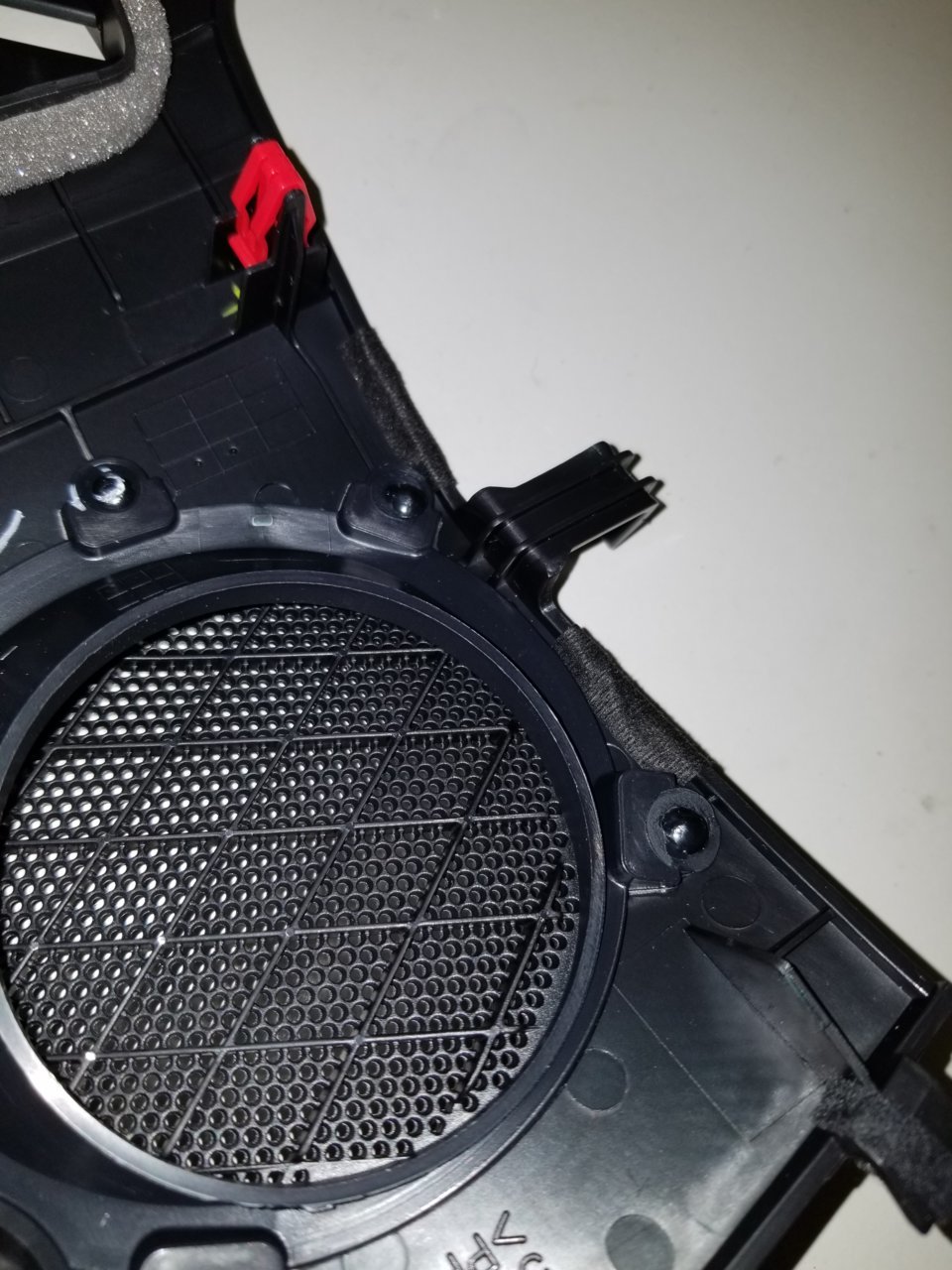

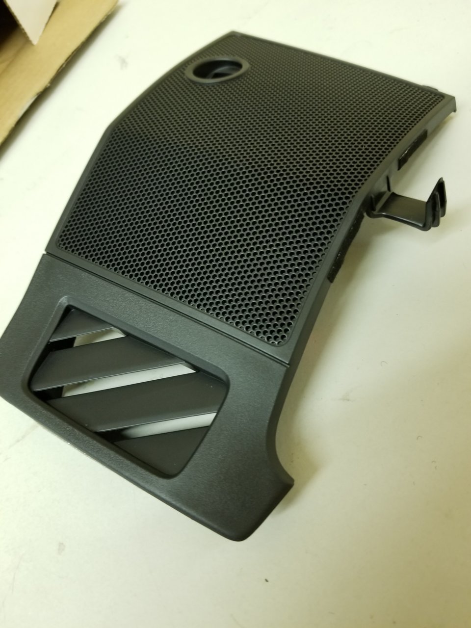

    Broke a tab prying off cover to put velcro on. I had one remaining tab so I put double sided tape at the other tab location and ordered another cover.
    Check this out. New cover doesn't have the little nubs, and it came with damping material already installed in the problem area.

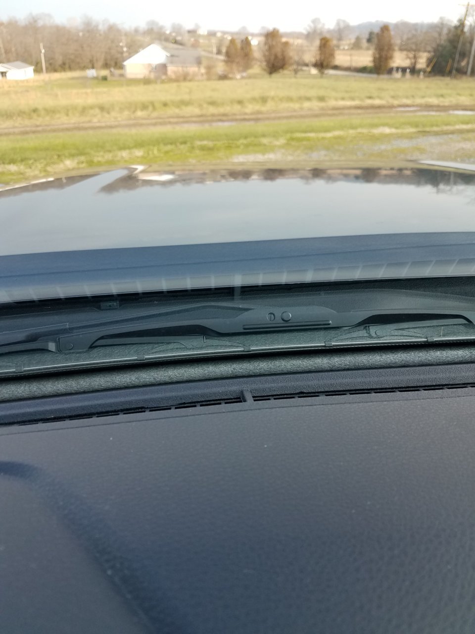

    I haven't used it because my previous fix (velcro fuzzy on the same area) fixed that particular rattle. However, I have two other unsolved dash rattles which I believe may be the external cowl tapping on the windshield.

    I had several mysterious dash noises besides the PS Speaker Cover, stuffed that round foam at the front of the dash and base of the windshield and it's so much quieter now.
