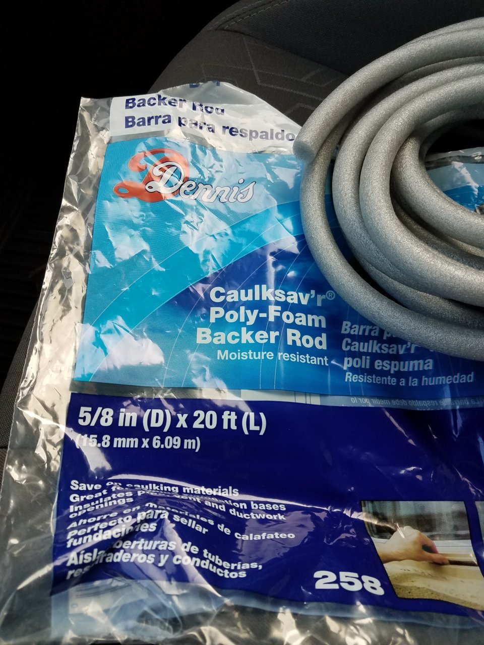

    King suspension w/ compression adjusters custom valving and 700# coils. Icon DJ uca. Icon RXT leafs Option #3. Durobumps. Demello rock sliders. Demello 30” Light Bar Baja Hoop bumper with Smittybuilt X2O winch w/ Amber baja design fogs w/ single row Baja Designs S8 amber light bar. Brute force Fab HC rear bumper. Behind Grille Light bar. TRD Pro Skid plate. Pelfrey Mid and Transfer case skid. TC spindle and cam tab gussets. Pop and lock. Method NV wheels 16”. SpiderTrax 1.25” wheel adapters. Yokohama Geolandar M/T (315/75/16). CMC. Radiator core reinforcement. Pro grille. Tailgate inlays. Baja Designs A pillar Ditch lights. Leer 100 XQ shell w/ power locks. In bed mounted spare. Blacked out emblems. Bed Mat. Bed Stiffeners. K&N air filter. Black Headlight Mod w/ LED projectors. Wrap Armor Anti glare hood and bedside decals. American flag decals. Northstar 24F AGM Pro battery. Differential breather relocate to rear tail light. Prinsu Designs Cabrack and Cap rack. OVTUNE Sibi Custom performance 4.88 91 fuel AGM . Nitro Gear 4:88 gears. Mountain hatch tailgate insert. In bed mounted Krazy Beaver shovel with Relentless quick fist bedrail mounts. MESO ultimate turn signals. AJT Designs Quicksand Key Fob. ECGS front needle bearing bushing replacement. Tepui LoPro 2 RTT.
    Just installed that all the way across my dash twice and it is quiet. Thanks!

  3. Dec 7, 2018 at 12:39 PM
    #223
    shakerhood
    shakerhood Well-Known Member
    Aug 9, 2015
    #161370
    37,042
    Southern Ohio
    2017 MGM DCSB Off Road, 6 Speed MT, P&T
    Glad to hear it helped with your truck too!

    2018 Red Tacoma OR
    Took my Taco into the dealer a few days ago and told them where I was hearing the rattle (left front twitter speaker). The guy said they that this is a known issue and they knew exactly how to fix this. When I got it back I asked how they did it and the technician told me they just pulled it off and put some foam tape on the that plastic piece - which is what everyone else seems to have done as well.
    All that said just to let people know they can take it to a dealership and they should fix it for you as they did for me.

    If you don’t want to risk breaking clips on the speaker cover, I’d recommend using some painter’s tape to mark the seam on the pillar cover where the speaker cover meets with the pillar. Do this while the pillar cover is still installed. Then pull the pillar cover and apply the felt tape along/below your tape line and reassemble. It’ll be invisible and you don’t have to remove the speaker cover at all.

    It’s crazy that so many people have that same rattle. My 2016 Sport had and my 2017 Off Road has it. I used some felt between the panels and it has stopped it for the most part. Still get a “tick” every now and then on really cold days, but it’s not bad. Maybe I’ll try the round foam that @shakerhood used to quiet things down further.
