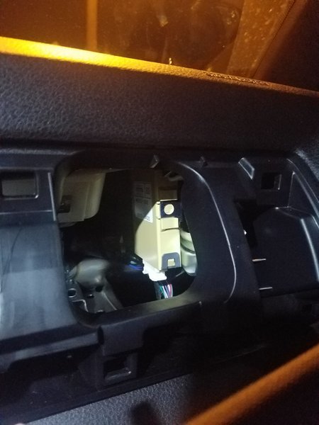

    I had this same problem. it started around 6500 miles. I took that passenger front speaker grille off and it still made that annoying rattle. After a little more investigating I found that the culprit was a plastic box right behind the dash. I fixed it by taping it tight to the metal bracket with electrical tape and then zip tying it to the same bracket. Its been about a week now and absolutely no rattle.
    I recommend trying this first before you take the speaker cover off. I too snapped off one of the tabs on the cover trying to take it off.

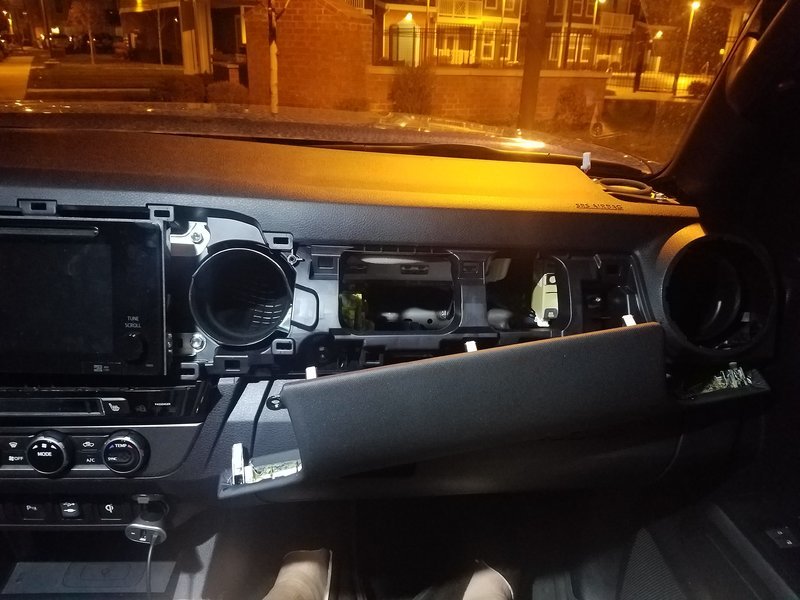

    Thanks Matttrow I will give that a try , I have taken the dash off so many times that when I was going home a week ago and heard that noise again I was able to pull the cover around the screen off while still driving!
