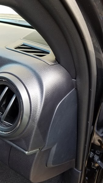

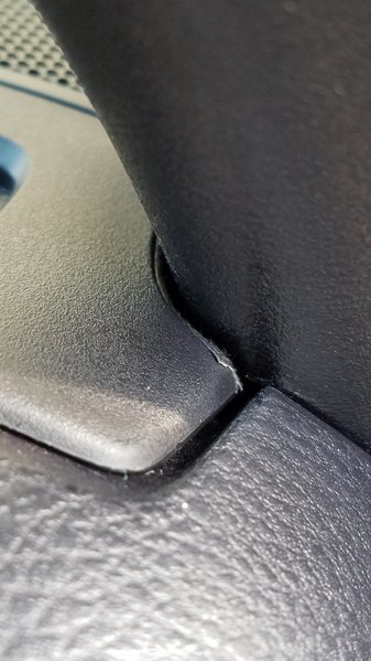

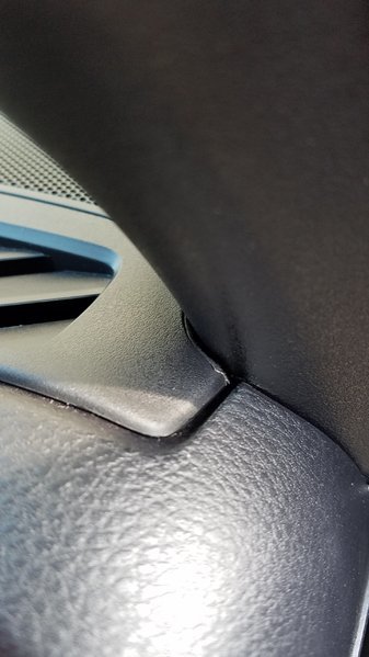

    Just picked my truck up after 5k service. I mentioned the daah rattle told them it was the little cover and if you push it down it doesn't make any noise. Got it back they said "Your speaker was loose we tightened it down" Here's what they actually did. Most people would ever notice if they took i5 in for a dash rattle just thought it was funny they "tightened" my loose speaker
