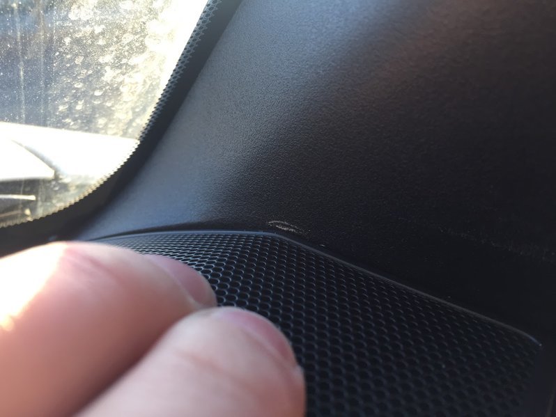

    I'm currently using the same "wedge some crap in the seam" solution as @NoDak but will add another photo in case it helps anyone. My noise started after some rocky offroading recently. The trail was rough enough that the speaker portion rubbed a mark into the adjacent panel, which turned out to be helpful when I started trying to pinpoint the source of the sound.
    FWIW, I'm at 8100 mi with pretty frequent offroading en route to backpacking/canyoneering trips, so I'm kind of surprised it took this long. It probably coincided with temps finally dropping here in AZ.
    I thought about shaving it down, but may try putting a bead of black silicone between the panels where the scratch is first.
    I'm pushing down on the speaker in the pic below to show the contact point:

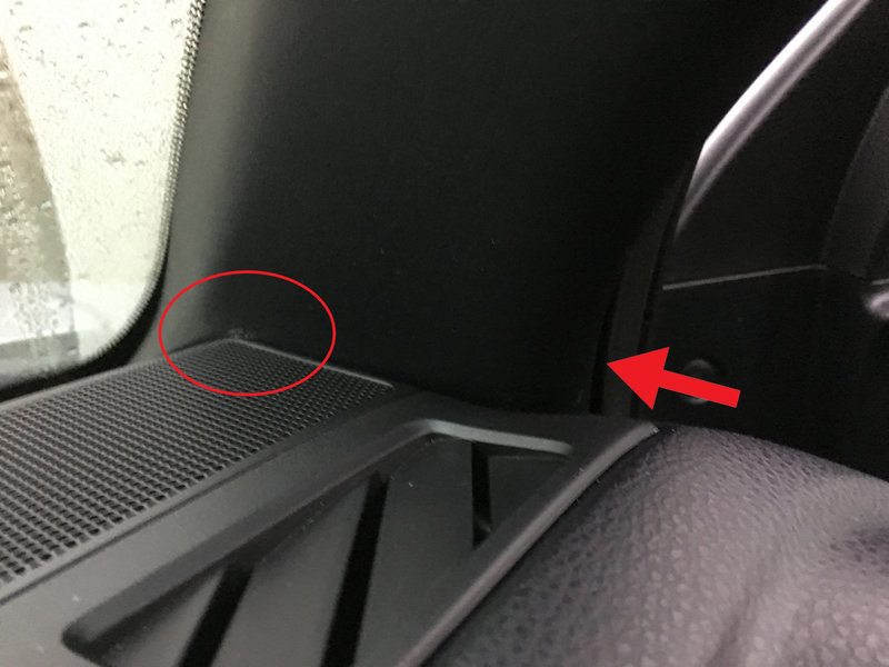

    This noise was driving me insane!!! much like everyone else it only happen in cold temperatures (50 degrees and below) and once the truck warmed up it seemed to go away. In the picture attached you can see the contact point ( nearly identical to @chefboyarfeez ). I gave the A pillar a swift hit where the red arrow is in the picture and molding pop into place. I'm not sure if passengers using the handle on the A pillar pulled the plastic molding out or if it was never properly installed but it's been about 5 days now and I haven't heard a peep out of the dash. Fingers crossed that it's now 'solved', hope this is helpful for someone else out there with this same issue.

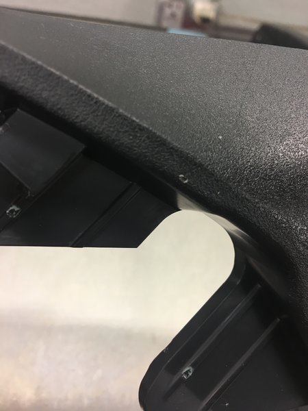

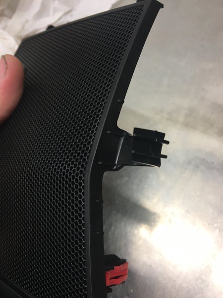

    Working on a customers vehicle with this right now.
    Attached some pictures showing a small nub on the speaker cover lines up perfectly with the mark on the pillar. It is the Top one in the picture.
    I shaved the nub off with a razor and put a small piece of foam insulation in there.
    From taking my own one apart three times, I may have warped one of the panels slightly and I no longer hear it, but I think I'll do the same as I just did here anyway.
