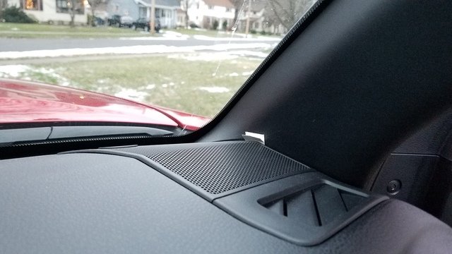

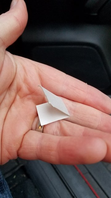

    Well the rattle can came back after the bang on it and hope it goes away temporary fix. Did find a good use for all those business cards from toyota reps. In other news, I need to clean my dash.

    Well after driving today, the velcro strips seemed to have fixed my tapping noise.
    Nice!!! Did the tapping go away with that method??? I choose the clean route...small cut pieces of velcro one where your business card is, and one piece just fwd.

    It stopped it for now anyway. Had it a little further forward and it was still creaking so moved it there and that seems to work. Probably take the a-pillar off Saturday for a better solution

    I should have used something other than tooth picks. The other day I noticed one of them was missing and the other was headed in the wrong direction. How the heck am I going to retrieve that MIA tooth pick ?

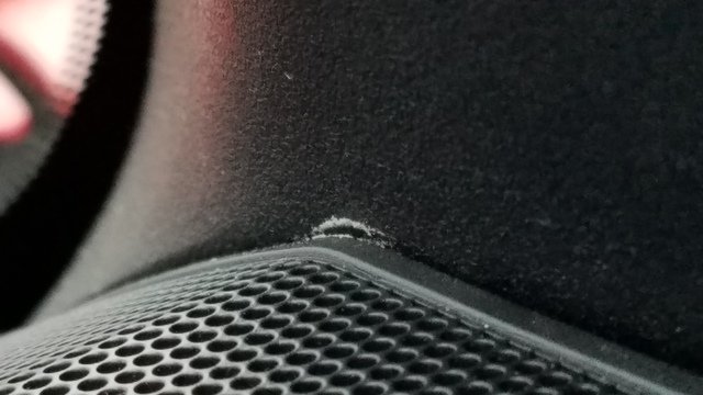

    R.Shaw
    R.Shaw Well-Known Member
    Jan 11, 2016
    #174663
    707
    2016 Tacoma 4X4 TRD
    it's that for sure, i can see a high point where that point in the speaker has cut a grove into the pillar.
    I'm just glad I'm not the only one this bugged the shit out of.
