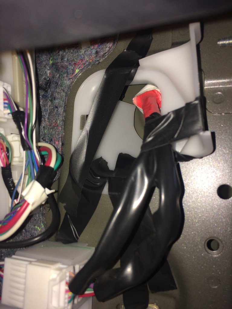

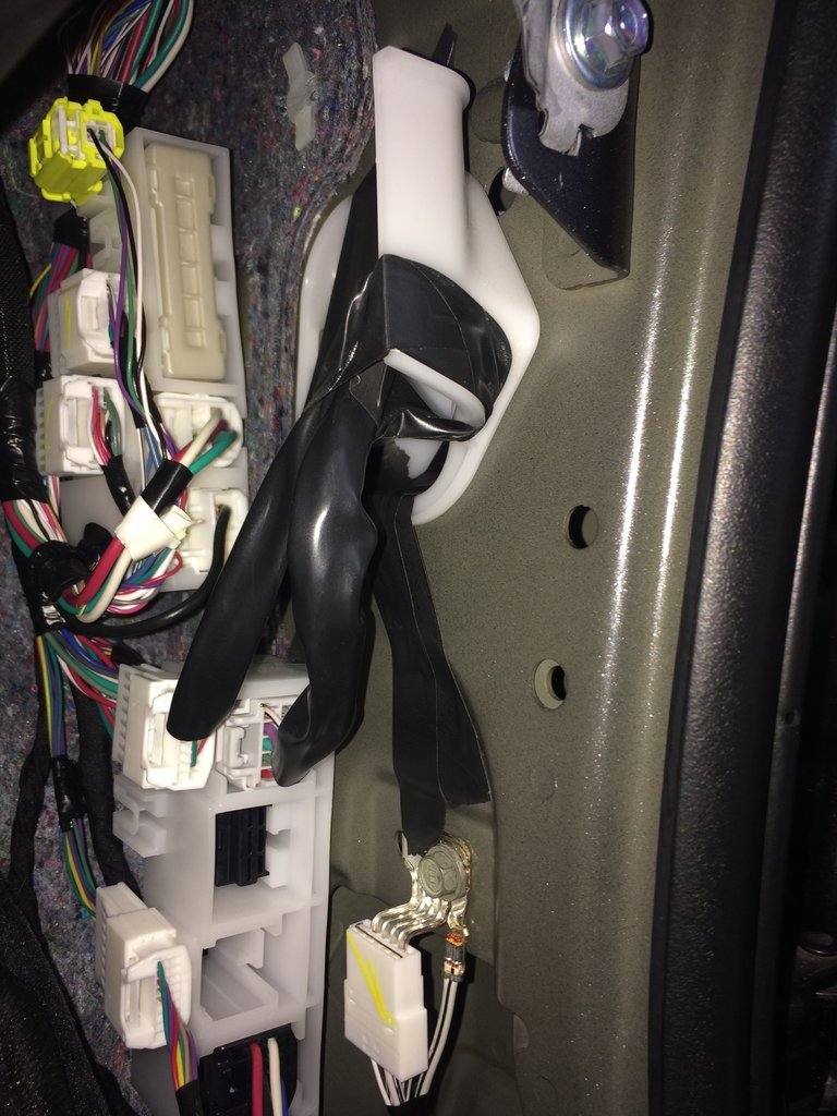

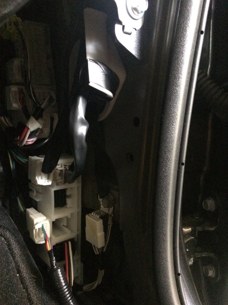

    I joined TW because I needed to know that someone else had this same issue. In my 2016 DCSB 4X4 the noise sounded like the dash speaker on passenger side rattling. Same issue as many of you, took it to the dealer (50 miles away) multiple times and they "could not reproduce" the noise. Frustrated, I started taking the dash apart to find the issue myself and solved my problem and hopefully many of yours as well. When I took off the passenger side kick panel off I found the issue. The photos are not the best but where the 2 wiring harnesses go into the body there is a white plastic piece that I assumes "pads" the hole in the body so as to not damage the wires. That plastic piece was rattling against the metal causing the sound that drove me crazy for 12 months. I hope this helps some of you solve your problems with this aggravating problem.

  9. Jul 21, 2017 at 4:35 PM
    #109
    Jukeboxx13
    Jukeboxx13 Well-Known Member
    Oct 5, 2016
    #199054
    830
    California
    2017 TRD OR DCSB 4x4
    Any tips on how to take the dash apart?
    Can you post a photo of what the kick panel is?
    Sorry I just started getting I to cars and trucks so I do t even know.
    Fieldy23[QUOTED] likes this.

    I'm going to try the kick panel thing and see if it works.

    Did the kick panel fix and still have the rattle/tapping.
    O wells I'll just have to wait until some other tips come out.

    I apologize Jukeboxx, Im just now seeing this question. Glad you figured it out, unfortunately mine started again about 5 days after I "fixed" it. Doesn't seem to be as bad as before but I guess its back to the drawing board.

    Thanks Silver, I tried that one first. I thought sure I had it fixed with the dashboard removal. Its a dang frustrating problem
