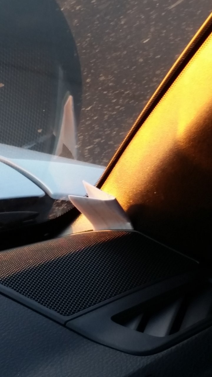

    I added a very small piece of rubber between the pillar and the speaker housing and mine stopped..
    shakerhood likes this.

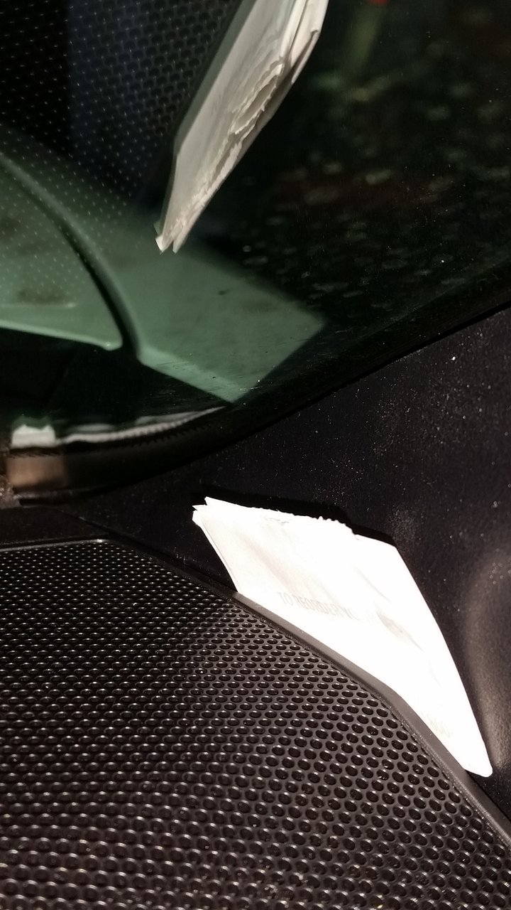

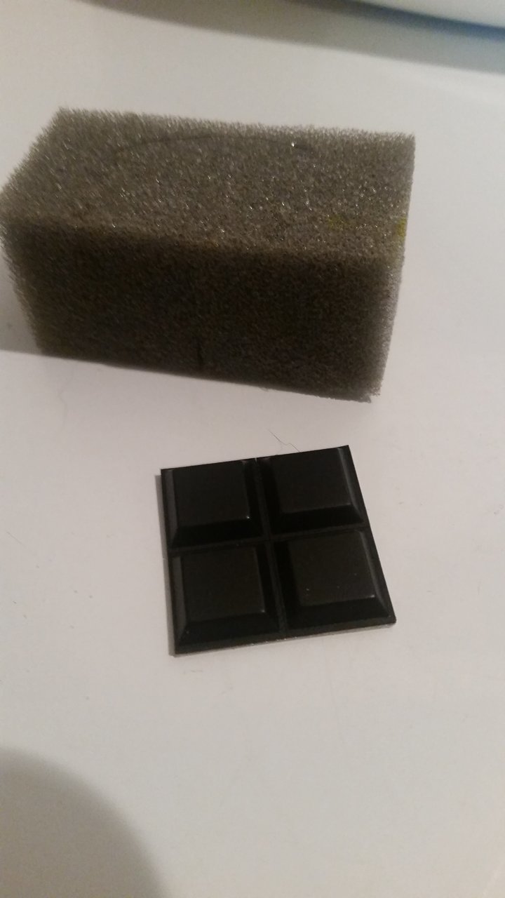

    So I got in the truck to head home today and drove 100 ft and heard the popping/ticking sound. Immediately grabbed a receipt that was sitting in the seat, folded it up and shoved it that summbich in there real tight (between the speaker cover and the passenger side pillar). Drove home in silence and never heard it again. I'll replace the receipt with a rubber shim and/or foam padding (pictured below) tomorrow.
    Worth noting that I had not turned on the heat yet so the temp inside had not yet had a chance to climb. I can confirm that the symptoms were not present in warmer weather.
    Thank you very much OP and to those that contributed to this post. :hattip:

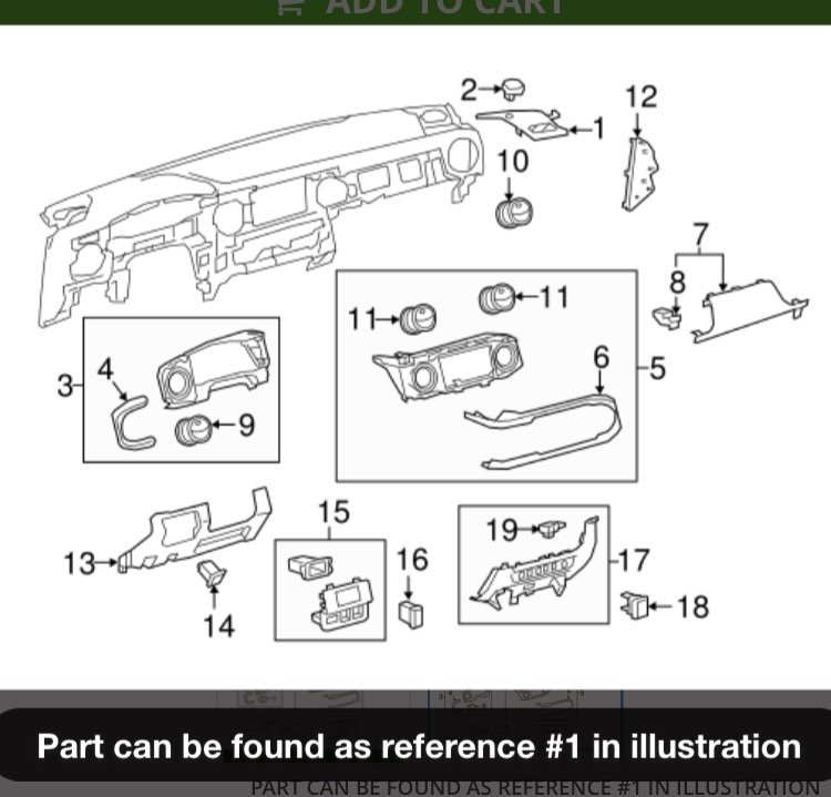

    Thanks for that. I have the dash rattle too, and was planning on pulling the A pillar to try and quiet it. Maybe this part is the answer. I wonder what's new and improved about it.
    Here's the parts diagram for all interested:

    i just stuck a folded up parking lot ticket in the side of the speaker. resolved.
    sad.
