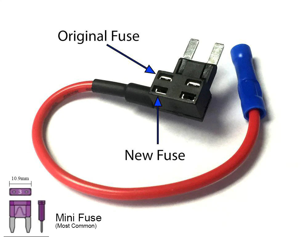

    Hi all, How have you tapped power from your cigarette lighter? I was hoping there was an aftermarket dongle or harness available to plug into the back of the lighter then plug the harness into that. Is there any other behind dash power source that people are using with a plug and play harness? I try to not ever cut wires in a car if I don’t absolutely have to.

    Depends what you want it to do and what sort of current you expect to draw…
    look at the handy chart on the fuse panel lid(s).

    as @MNMLST has posted an add a fuse/add a tap is easy to do without messing with wiring. If you do a quick search on DVR add a tap or something like that you will see there are diagrams for adding this fuse line to the mini fuse box on the 3rd gen left side of drive side next to ODBII port. It's real easy to simply pull the oem fuse, plug this one in and add a 2nd fuse as posted on his pic.
    I have this exact setup for my DVR and it turns on and off with the vehicle.

    •tap into the fuse panel on the drivers side
    •screw the doohickey to something nearby
    •run some long power cables up and over
  18. Feb 3, 2023 at 5:56 AM

    with some creative yoga and a ‘fishing wire’ you should be able to get over the steering column and behind the dash without taking much apart. make sure to zip tie your final bundle so it doesn’t fall down around your feet or rub on anything (there’s all sorts of places). I’d just tap into an accessory fuse, like the radio, or….
    just quit messing around and put a 3000W inverter under the passenger seat
