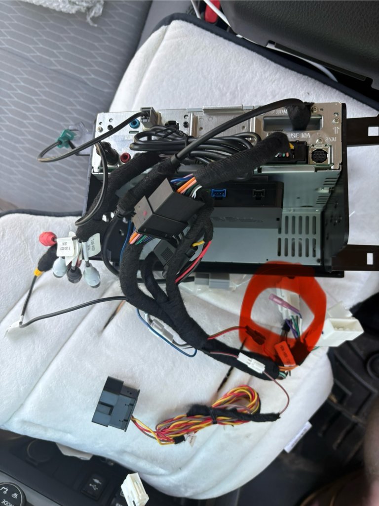

    I don’t know a ton about car audio, so maybe out of my league here, but I got the trail grid pro Sony ax6000 plug and play unit. Love it.
    Needing more umph for my 4ohm Focals and will probably net with a 4ch 60 watt rms Alpine amp. I’m gauging whether to DIY or hire it out. Power and RCAs are straightforward.

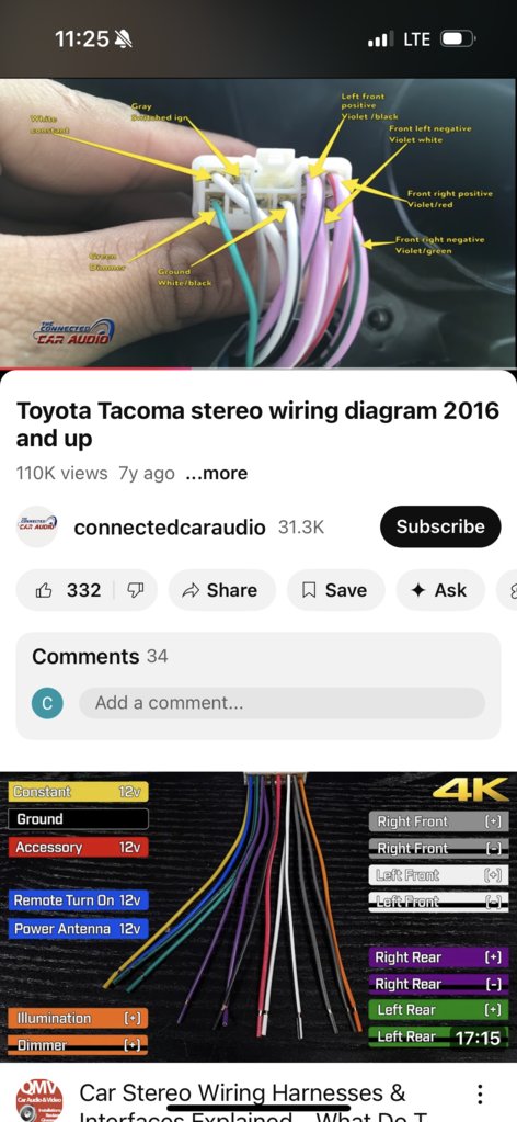

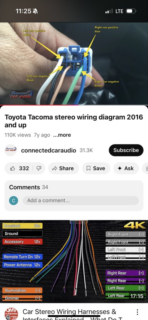

    Amp outputs, could I just run a 9 wire directly to existing speaker wire harness and tap the (+\-)s using the diagram below and tapping the remote turn on trail grid provided? See below. Most threads I saw were for factory radio, but if there’s any tutorial out there for aftermarket stereos, please post below.
    cheers

    Once you have an aftermarket radio, you should have RCA outputs to connect to the amp.
    After that, you really just need to cut into the wiring harness adapter behind the radio.
    Cut and cap the speaker connections from the radio, and splice the amp outputs to the speaker wires in the adapter harness

    I kept my factory HU but you can do the same with an aftermarket HU.
    I bought two adapters for my wires right out of the HU. One plugs into the factory HU and the other into the truck wiring harness. This allowed me to get access to the speaker wires coming out of my HU without cutting any factory wiring… while other wires like power, ground, etc are simply connected to thru the two harnesses.
    With the speaker wires coming out of the HU, I used a speed wire to connect to a line out converter linked above my post. This lets you “level” the signal coming out of your HU (e.g. increase output to quiet rear speakers). I then connected the LOC to my amp and then ran new wires to the each speaker to power my focals and sub.
